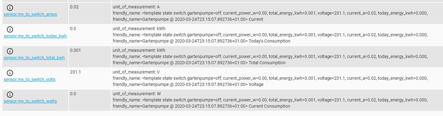

How i create a service?
I have “sprinkler.turn_on” but it seems that it runs into an issue as you can see in my screenshots…
And if I look in developer menu - services, I can’t find the service.
