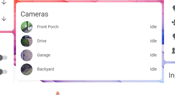

I just use a default card and have camera entities specified for the card. This only shows a static thumbnail image of the camera feed, then when you click it, it will bring up the live feed.
Click the round thumbnail in this view.
c1
Then you will get this view.
This should keep it from streaming constantly and only stream when you want to see the live view.
