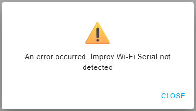

I restarted with the “prepare for first use”. It was successfully installed but than if you click close, it should ask you for wifi connection but he gives me next window:
Best regards,
Bossi
