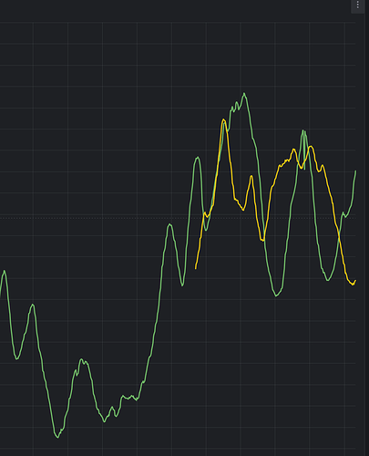

Thank you for your work and sharing it @eldigo.
I have installed and configured influxdb and homeassistant and had run your script to migrate all data from sqlite to influxdb.
I have set a source of HomeAssistant for the influxdb integration instead of HA.
After the migration i have two sets of sensor data for outside temperature, one with source HA another with source HomeAssistant.
(No problem with that, will correct it later and restart.)

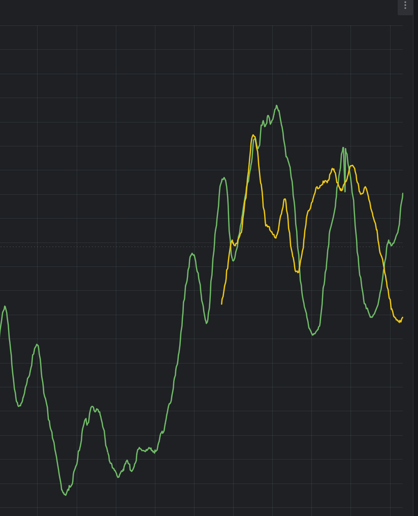

But i have detected an overlap between the two graphs in grafana.
Do you have an idea how to correct it when i rerun the script?
(green= source HA)
The overlap starts at 15:24 and ends at 18:32, so does not seem to be UTC to local time difference which is 2h.
But when i look at the temperature at start and find one where it could append that seems to be 2h. I think a have a problem with the time setting somewhere.
@eldigo
I had a conversation with Gemini about my finding and Gemini came up with a code modification to your script which i have adopted and tested.
It seems to remedy my problem.
The timestamp from the sqlite database is converted to UTC before inserting into influxdb.
I could attach the modified code for inspection and adoption?
