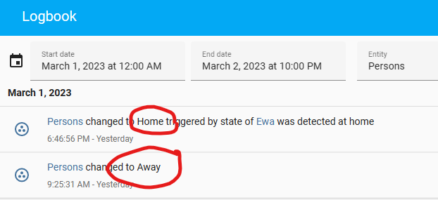

Yes, I found that.The strange thing is that when I check the history as well as the state value in the developers page, they both list the value as away
and home
It doesn’t say not_home
so intuitively I assumed that the docs were just outdated.
The actual state is shown in the state table on Developer Tools / Template: it’s that one you want, rather than the “sanitised”, friendly-but-incorrect version shown elsewhere:
Aha, I see. Many thanks. Is this a case of inconsistency, or just by (good?) design, I wonder…
