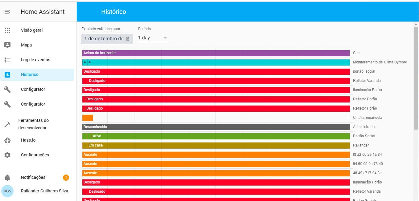

Hello people. I’m having trouble viewing state history. When trying to view some state history the message “No state history found.” Is displayed.

I am trying to see state history because it gives me the possibility to see for example how long the external illumination has been on.
I have a presence sensor that without the history I can’t see the detection history.
When I go in history I can only view the histories of two days ago.
Could it be something with my time / zone or incorrect date and time?
Mysteriously, the State of History came back to work.
