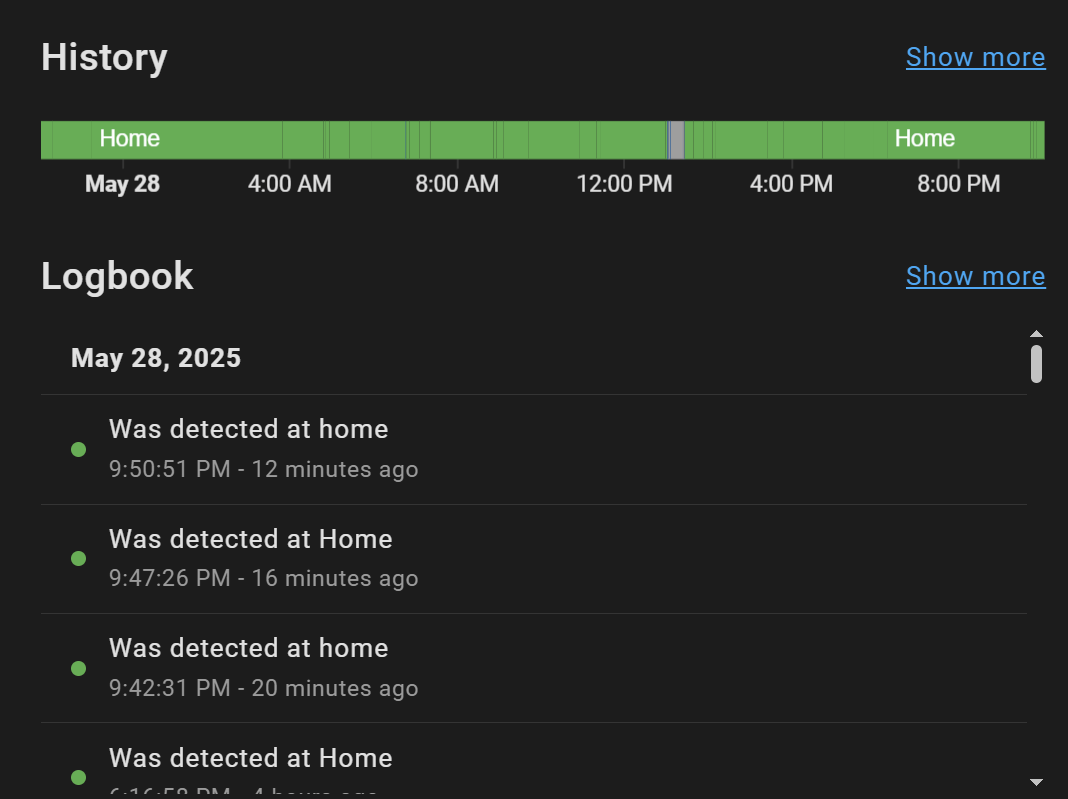

@Blacky Not sure if this is specific to a ā€˜Person’ entity but I get a lot of triggers when the entity is set to Home. I dont mean ā€˜changes from Away to Home’ I mean from Home to Home.
the BP says ā€œEnter the entities that will trigger the automation on state change.ā€ so I assumed that meant the state became a different value but its triggering without a value change.
as you can see, there was no state value change (and it looks like this happens frequently)…
ā€œHomeā€ and ā€œhomeā€ are different zones. I’d be looking closely at any config related to zones & removing the duplicate.
There will be something there. You will need to look and see what it is doing. Maybe it is becoming unavailable then home.
Blacky :grinning:
thank you. I suspect that was it. I dont recall making a ā€œHomeā€ zone manually but I had two zones named exactly ā€œHomeā€ (both with first letter in caps)
… HA system must have internally converted one to lower case ā€˜home’… that was not visible, only the ā€œHomeā€ was.
thx again!
The lower case one is created as part of the onboarding steps (when it asks you for location and to define a home radius). The UI will show it as Home to prettify it.
You might not have realised and created another ā€œHomeā€ zone via the UI. Given that under the hood, home and Home are different, that would explain the 2 home zones.
