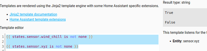

I want to {% set %} a certain value to another variable depending on whether a certain integration exists and, in turn, whether the sensor.home_realfeel_temperature entity is available and has a state value or not.
Thank you, sir! The answer seems to have been as easy as your nickname :smiley:
you can also use the following to check if the entity exists:
{{ states.sensor.something.state is defined }}
