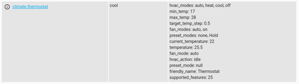

Go to Developer Tools > States. Whatever you see in the rightmost column resides in the entity’s attributes property and can be accessed using state_attr(). The center column represents the entity’s state property. You can use the states() function to acquire it (or by using states.sensor.whatever.state).
Here’s an example of my thermostat. It’s current state value is cool. I can use this:
state_attr('climate.thermostat', 'temperature')
to get the value of the temperature key in the attributes property. You should know that most people abbreviate it and just say ‘get the temperature attribute’.
