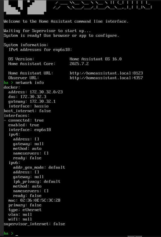

Here’s the screenshot of the terminal window right after i set the dhcp static assignment in opnsense.
All i did was set the ip in opnsense to 10.0.0.15. On install it’s 10.0.0.141/24
What do you mean by this picture / log

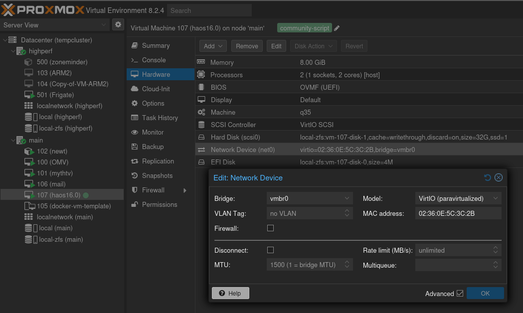

Are you setting the mac in the proxmox settings? If not the vm will be a different address.
I am not setting the mac during install. It changes every time i install in the new vm. opnsense knows what the mac is the first time it grabs an address.

In proxmox go to your vm settings hardware network and the mac can be set there. If you are doing it anywhere else. It going to cause problems. Change it there to whatever your dchp likes.

What would i need to provide from proxmox to help diagnose? In the VM as running, there’s not much to show.
I’m very familiar with these threads. They’re talking to people who don’t have very solid networks or don’t understand how DNS or dhcp actually work. Set static is a shotgun network guy answer that clears up a lot of problems. That’s all. If I don’t have time to troubleshoot what your net is doing and you’re flat. Set static call it done. What you’re really looking for is STABLE
Here’s the VM HA is installed on.

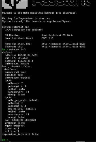

This may also be useful?
Then there’s this: trying to reset HA back to dhcp, it fails to take.
