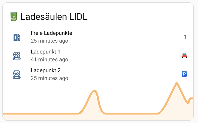

Just dropping my code here:
rest:
  - scan_interval: 60
    resource: https://enbw-emp.azure-api.net/emobility-public-api/api/v1/chargestations/XXX
    headers:
      User-Agent: "Home Assistant"
      Ocp-Apim-Subscription-Key: "XXX"
      Origin: "https://www.enbw.com"
      Referer: "https://www.enbw.com/"
    sensor:
      - name: LIDL - Freie Ladepunkte
        value_template: "{{ value_json.availableChargePoints | int}}"
        unique_id: "charger_lidl_freie_ladepunkte"
        unit_of_measurement: ""
      - name: "LIDL - Ladepunkt 1"
        value_template: >-
          {% set t = value_json.chargePoints | selectattr('evseId','eq','DE*LDL*XXX') | map(attribute='status') | first %}
          {% if t == "OCCUPIED" %} 🚘
          {% elif t == "AVAILABLE" %} 🅿️
          {% elif t == "OUT_OF_SERVICE" %} ❌
          {% else %} "{{ t }}"
          {% endif %}
        unique_id: "charger_bv_ladepunkt1"
      - name: "LIDL - Ladepunkt 2"
        value_template: >-
          {% endif %}
        unique_id: "charger_lidl_ladepunkt2"
unit_of_measurement is important to get Home Assistant in the mood to generate graphs.
unique_id helps when editing stuff via the ui.
Cards show last change of the property as subtext.
type: entities
entities:
  - entity: sensor.lidl_freie_ladepunkte_2
    secondary_info: last-changed
    name: Freie Ladepunkte
    icon: mdi:ev-station
  - entity: sensor.lidl_ladepunkt_1
    icon: mdi:ev-plug-ccs2
  - entity: sensor.lidl_ladepunkt_2
title: 🔋 Ladesäulen LIDL
state_color: false
theme: Mushroom
footer:
  type: graph
  detail: 2
show_header_toggle: false

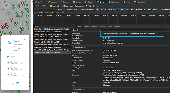

It can be done on several ways. My way was to make a sensor for each attribute.
Json response is in German, I translated some to Dutch.
Make a new folder in Home Assistant named :
REST
Add this line in configuration.yaml :
rest: !include_dir_merge_list REST/
Create in folder ‘REST’ a file with a recognizable name for the charge station, like :

Another simpler way is to get the links from : https://www.oplaadpalen.nl/
There is no API key and headers needed.
