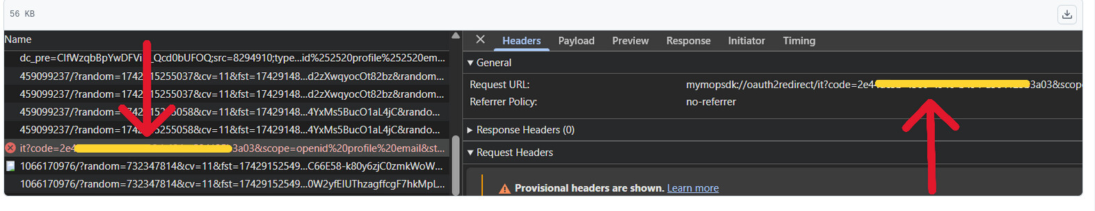

I am trying to add a Peugeot to this integration, but I am struggling with finding the OAUTH2 code described like this:
, it only describes a redirect at my side. I have tried FireFox and Chrome browser developer mode. Is it still possible to set up this integration, or has anything changed on the Stellantis side?
It also a possibility to run the python script ( GitHub - benbox69/stellantis-oauth-helper: This tool simplifies the OAuth2 flow for Stellantis services by dynamically loading configurations and providing a user-friendly interface. ), but guidance to do this, is much appreciated.
As you can see, the redirect try to open a native mobile app and get error (because you dont have it on your desktop), from this redirect copy the auth code and paste it on integration config flow :ok_hand:t2:

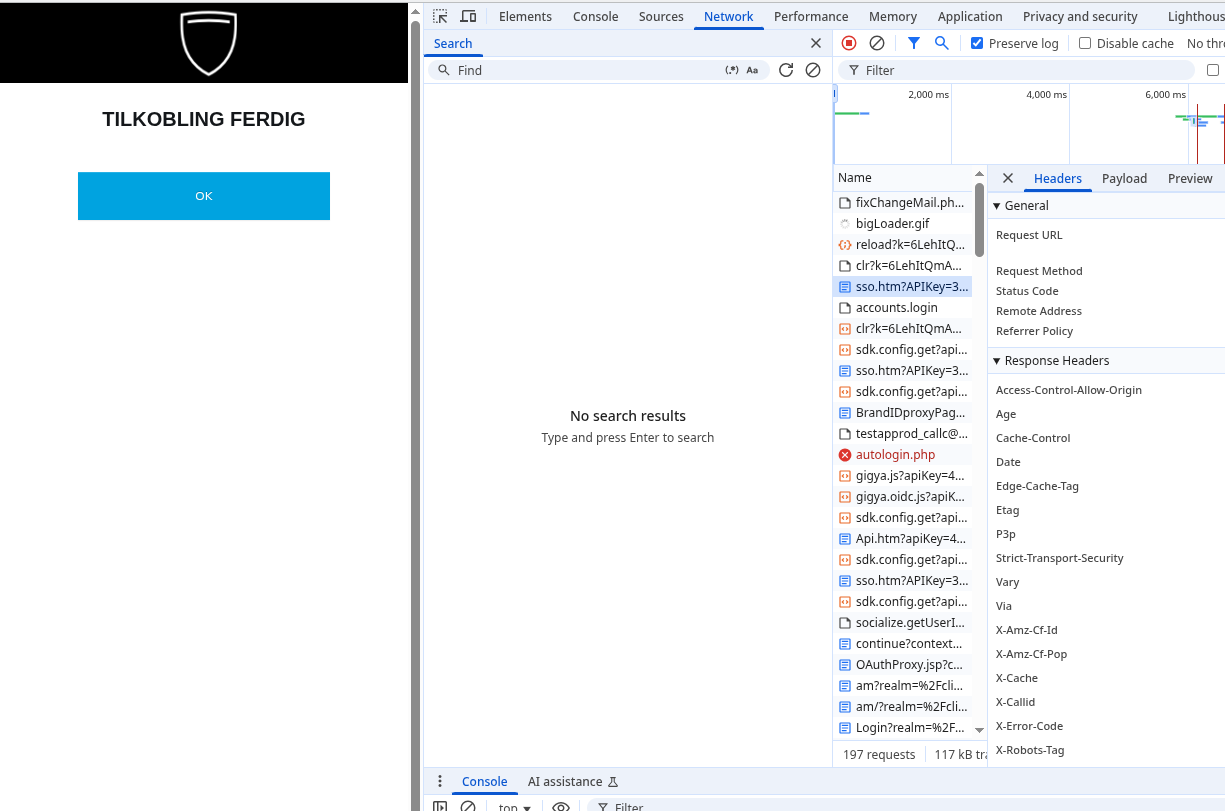

Sorry, I do not find what you are describing, even if I “preserve” log in Chrome.
You need to press OK and then fetch the code.
Thank you very much, now i finally got it!
I only found it by persevering (after giving up several times). I think you need to be pretty quick on the consol after pressing OK otherwise the API seems to get rejected as invalid when you try to use it.
