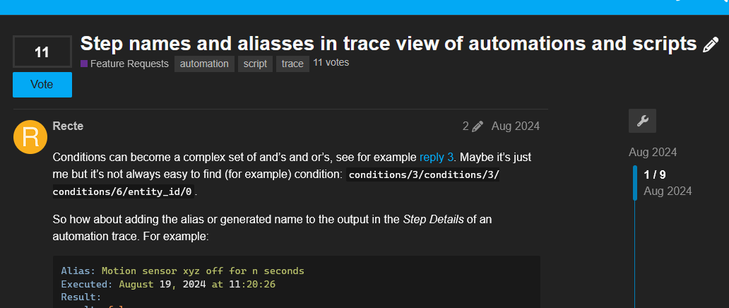

Step names and aliasses in trace view of automations and scripts
Conditions can become a complex set of and’s and or’s, see for example reply 3. Maybe it’s just me but it’s not always easy to find (for example) condition: conditions/3/conditions/3/conditions/6/entity_id/0.
So how about adding the alias or generated name to the output in the Step Details of an automation trace. For example:
Alias: Motion sensor xyz off for n seconds
Executed: August 19, 2024 at 11:20:26
Result:
result: false
state: 'on'
wanted_state: 'off'
It will make it a lot easier to find the specific condition in the Step config and in the automation editor. My suggestion would be to add the Alias or Step name (in case of a generated and not manually entered name) to all steps of the Step Details.
Vote if you’d like to see this feature added too.
Edit: Clarified the request by mentioning the parts of the trace screen and added the suggestion to add the generated step-names too.
