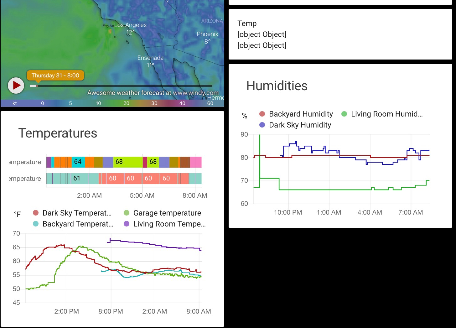

I have several sensor objects that I am to plot in a history-graph (temperature) card in Lovelace. Two of the sensors seem to return something different than the others. At first I thought it was the fact they returned values without a decimal part, but I have other history graphs (humidities) of other sensors with whole values that plot correctly.
When I try to use templates to display the two different sensor object types in custom markup card (temp), both seems to return:
[object Object]
for
sensor..attributes
See picture of problem card and other cards below:
are you referring to the bar graph vrs numerical graph? If so, you are most likely missing units on the bar graphs. You’ll need to delete your database for history to update it too because it will think it’s a string forever.
And by units I mean unit_of_measurement. Which can be set inside customize.
Also, if you want to view the state object, use the template editor.

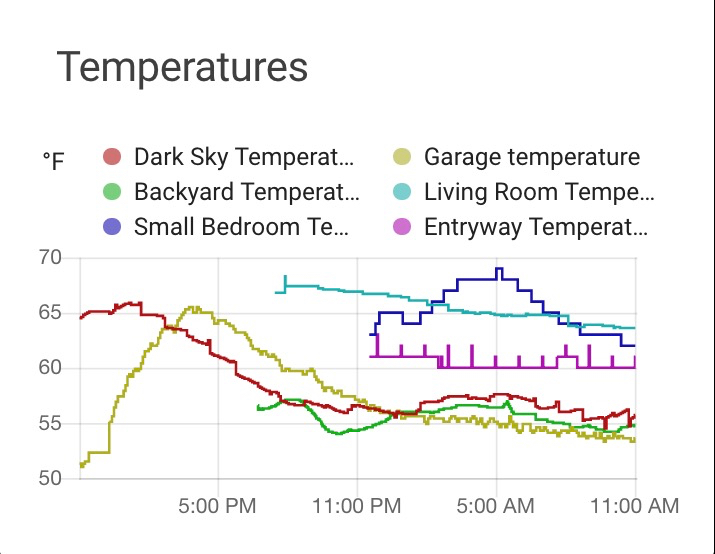

Great ideas, thank you! The template editor looks to be a very good resource, when I looked at it before your guide, it did not register to me what I could do with it. The Lovelace card I am trying to use is the ‘History Graph’:
Thank you, your idea about the lack of ‘unit_measurement’ for the two problem sensors was the issue. I added this attribute to the sensors to match the other and the Lovelace history-graph now displays correctly. No need to do anything with the database.
