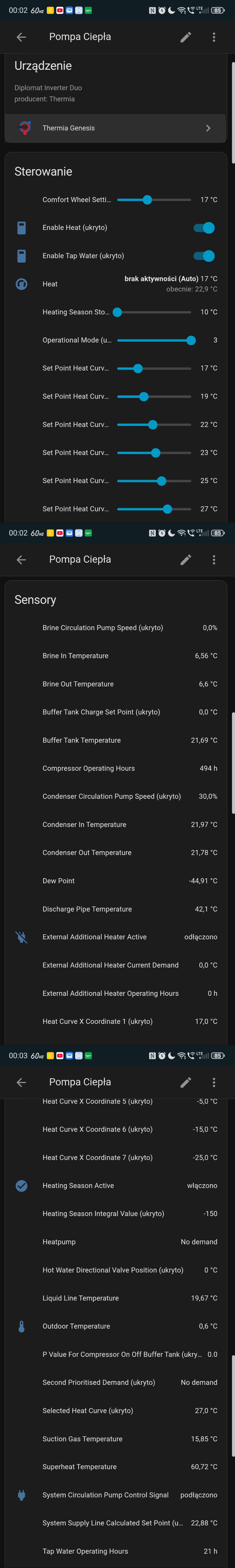

I have same heatpump and i’m using GitHub - CJNE/thermiagenesis: Home assistant custom component for Thermia Inverter/Mega heat pumps for communication with it. It works without ISG. Just connect Ethernet cable, activate BMS and set it to modbus tcp
