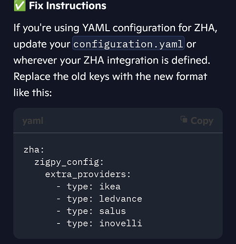

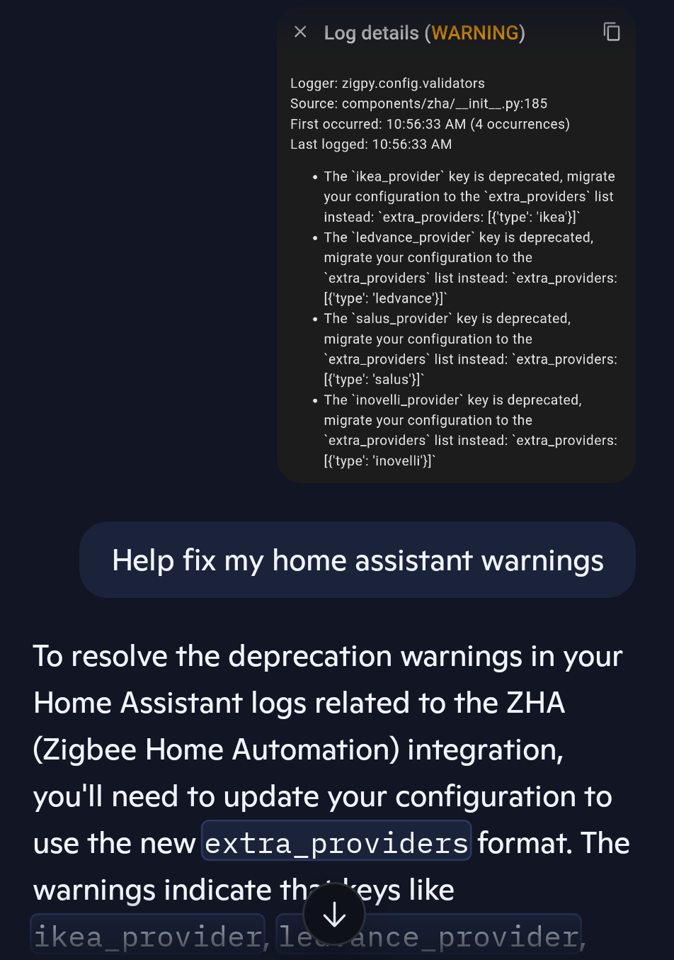

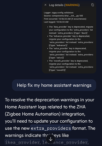

Ok, fixed it. I looked in the logs and saw warnings for ZHA. Took a screenshot of the warning and asked Copilot how to fix - see attached images from Copilot.

Copilot’s example appears to be missing the ota: key found in the official documentation.
FWIW, the warning message you received, concerning deprecation, was first reported by users well over a year ago. For example:
Is this the first time you have received the deprecation warning?
