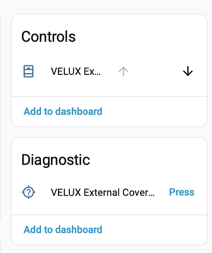

I did it by removing it from the Home App (in iOS) and then clicked “setup HomeKit” in the Velux App.
BUT: I would not recommend it. The result looks like this:
means: no stop button and no position. So the actions are open (complete) or close … is there any update in the meanwhile?
