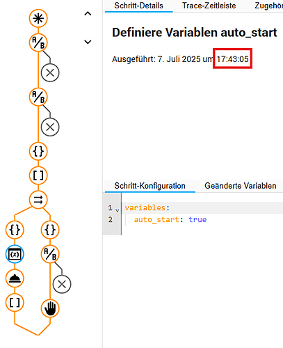

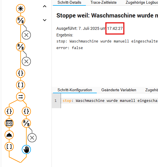

In principle, I only have one specific question about the parallel processes. As you can see in the picture, I want to use the stop action to stop the entire automation.
The stop action is executed, but the parallel branch remains active and reacts to changes. As you can see in the other image, actions in the other branch are still executed after the stop action has been executed.

That’s a bug, stop should stop the automaton. Log an issue with the simplest example possible.
Opened an issue: Stop action won’t work in parallel action branchs · Issue #148356 · home-assistant/core
