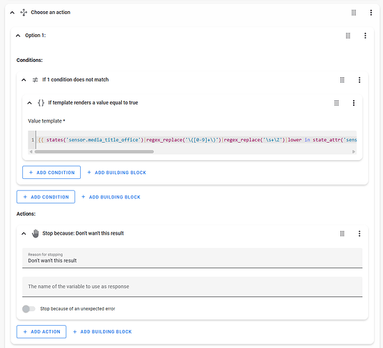

You can use choose in the script and then hit a stop …
Just call the script.turn_off service.
EDIT: that wont work.

Great comments! I didn’t know about the Stop action @Neil_Brownlee. Super helpful!

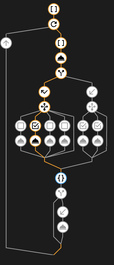

One of my scripts is working “correctly”. If I start the script 12 times in a row, I get 12 running instances, but if I start it again, it kills the others.
The other script though, it’s getting stuck. If I start too many, sometimes one stays around. It’s calling my other long-running script, so if that other long-running script stops too early, then it just gets stuck there.
Normal running
The {} icon is the “wait for”:
Stopped by duplicate call
This goes through my condition which checks if it was a duplicate call and logs that. The repeat isn’t triggered a second time:
Weird in-between state
This one never made it to the “wait for” and gets stuck here:
I think it had something to do with the script ending its own duplicate execution.

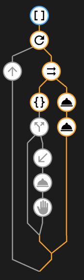

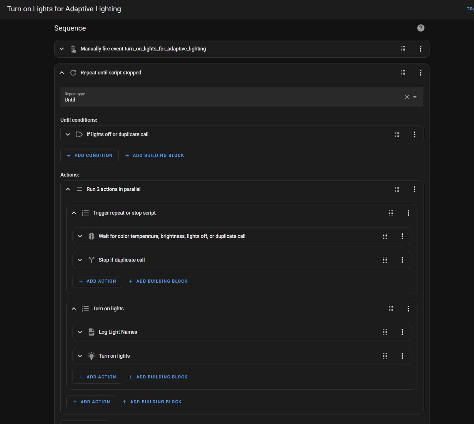

After much work, I finally got it!
Using a Parallel action with Stop doesn’t work if the Repeat is in a separate sequence, but if the Stop occurs in Repeat even if it’s parallel execution, then it works fine!
Normal
Stopped

It’s been so long, I’m not sure if this is the script you want @Phteven:
alias: Turn on Lights for Adaptive Lighting
fields:
  lights:
    description: The list of lights to turn on.
    example: light.living_room_lights, light.kitchen_lights
    required: true
    selector:
      entity:
        multiple: true
        domain: light
  id:
    selector:
      text: {}
    description: >-
      This is an always-running script until lights turn off, so you need to
      pass a unique ID, so its operation isn't duplicated.
    required: true
sequence:
  - event: turn_on_lights_for_adaptive_lighting
    event_data:
      id: "{{ id }}"
  - alias: Repeat until script stopped
    repeat:
      sequence:
        - parallel:
            - alias: Trigger repeat or stop script
              sequence:
                - alias: >-
                    Wait for color temperature, brightness, lights off, or
                    duplicate call
                  wait_for_trigger:
                    - trigger: state
                      entity_id:
                        - input_select.light_color_temperature
                    - trigger: state
                      entity_id:
                        - input_number.light_brightness_percentage
                    - trigger: template
                      value_template: >-
                        {{ lights | map('states') | select('eq', 'on') | list |
                        length == 0 }}
                      alias: When lights are off
                      enabled: true
                    - trigger: event
                      event_type: turn_on_lights_for_adaptive_lighting
                      enabled: true
                      event_data:
                        id: "{{ id }}"
                  continue_on_timeout: false
                - alias: Stop if duplicate call
                  if:
                    - alias: Is duplicate call
                      condition: template
                      value_template: |-
                          wait.trigger is defined
                          and wait.trigger.platform == "event"
                          and wait.trigger.event.data.id == id
                  then:
                    - stop: Duplicate call
                  enabled: true
            - sequence:
                - alias: Log Light Names
                    name: "Turn on Lights for Day & Night Adaptive Lighting:"
                    message: >
                      {% set light_names = lights | map('state_attr',
                      'friendly_name') | join(', ') %} "{{ light_names }}".
                  enabled: true
                  action: logbook.log
                - metadata: {}
                    brightness_pct: "{{ states('input_number.light_brightness_percentage') }}"
                    kelvin: "{{ states('input_select.light_color_temperature') }}"
                    transition: 1.5
                    entity_id: "{{ lights }}"
                  action: light.turn_on
                  alias: Turn on lights
      until:
        - alias: If lights off or duplicate call
          condition: or
          conditions:
            - alias: Lights are off
              condition: template
              value_template: >-
                {{ lights | map('states') | select('eq', 'on') | list | length
                == 0 }}
            - alias: If a duplicate call was made
              condition: template
              value_template: |-
                  wait is defined
                  and wait.trigger is defined
          enabled: true
description: >-
  Turn on lights to a brightness value based on the time of day and a
  temperature relative to the current weather.
icon: mdi:lightbulb-auto
mode: parallel
max: 100
