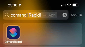

I experienced the same delay as iPhone user to report sensors informations to home assistant. The operating system decide when and in what condition report.
I solved this making a iOS automation using the apple application to trigger home assistant every threshold battery changes.
Can you share it? And any downsides (like reduced battery life)?
it’s very simple. here is a couple of screen.
I use the official apple application for automation on ios (the name is traslated according your language)
Creating an automation which just update sensors using the HA ios companion app installed, the the complete automation is done on HA.
I made two of this, on 80% and 100% to alway notify changes for “lower” or full battery level.
So i can charge my phone all night without overcharging or this way also my wall tablet can alway be connected to power without stay always full charged.
