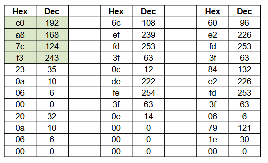

This are some of the IPv6 addresses that were shown:
c0a8:7cf3:230a:600::200a:600
c0a8:7cf3:6cef:fd3f:cde:fe3f:e00:0
c0a8:7cf3:60e2:fd3f:84e2:fd3f:679:1e00
Originally I thought that this ESP device was somehow connecting to a neighbour access point and been given an IPv6 address, but that would be very strange of course.
But it appears that the given IPv6 addresses are based on the IPv4 address!
The first two groups of these IPv6 addresses are in fact the IPv4 address transferred from decimal to hex numbers.
c0a8:7cf3 = 192.168.124.243
It however is not clear what the other hex numbers are.

And in my case the IPv6 address starts with the IPv4 address in hex format.
So I think it is still unclear as to what is happening here in my case.

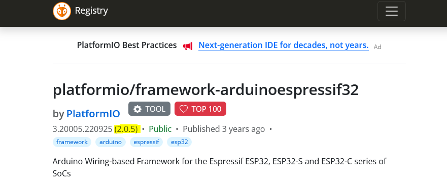

I think I found out what the previous version of the Arduino framework version was, as used by ESPHome 2025.6.3
In the ESPHome version 2025.6.3 code on GitHub, in the file platform.ini this is shown:
[common:esp32-arduino]
extends = common:arduino
platform = platformio/[email protected]
platform_packages =
    platformio/framework-arduinoespressif32@~3.20005.0
Following the platformio website this probably is Arduino framework version 2.0.5
So I did try to use ESPHome 2025.7.4 with Arduino framework version 2.0.5

For clarity: in my case the first two groups of the IPv6 address were a hexadecimal representation of the IPv4 address, like shown in my original post:

0a00:005b = 10.0.0.91, so it checks out. I know next to nothing about IPv6, so the remaining digits don’t mean much to me. Timing is quite random - can be as frequent as 2 minutes or irregular as 30 minutes. IPv6 addresses only ever appears for a second or so before it is replaced by the IPv4 variant.
