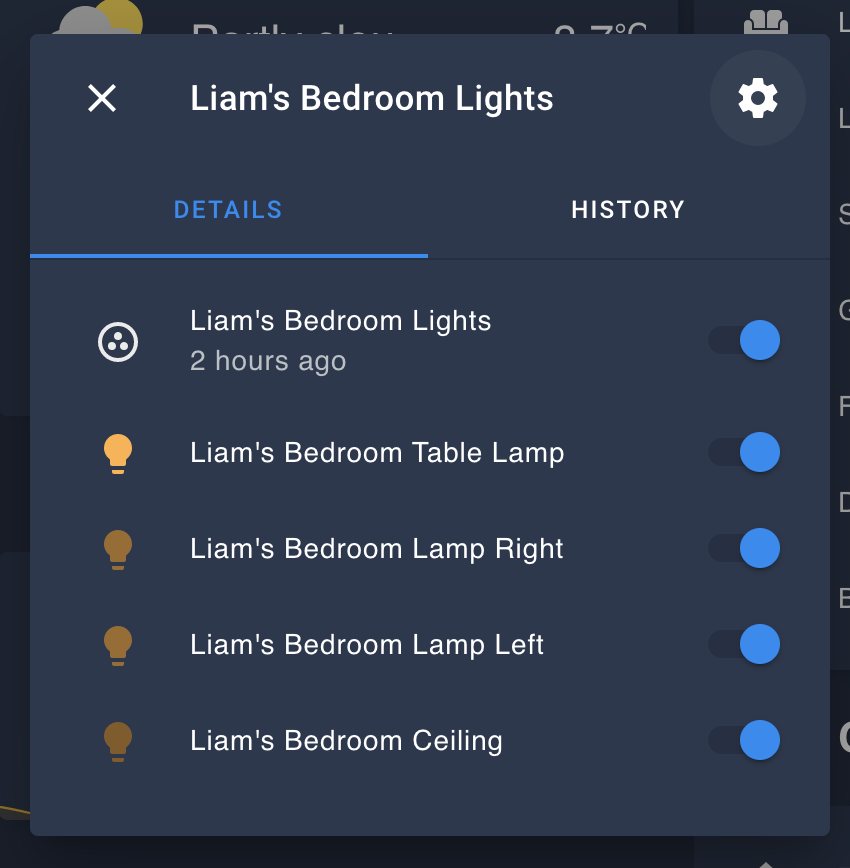

I am having an unusual problem with my groups of lights, I have several groups and one Zone which contains the lights from several other rooms, I am having a strange issue where sometimes the group is recognised as light control.
And other times it only shows on/off controls.
I have tested this with various circumstances such as using different (and default) themes, having only one group, a mixture of light groups and regular groups, different devices, trying with all lights on and some lights off. The colour wheel and brightness seem to only come up randomly and I cant pin down why. Strangely enough it seems to happen more often with Zone 1 compared to the other groups.
Light group works okay but I unfortunately can not use them for my Zone 1 due to not having the all options which I require, plus having individual light controls from the group is fairly handy.
