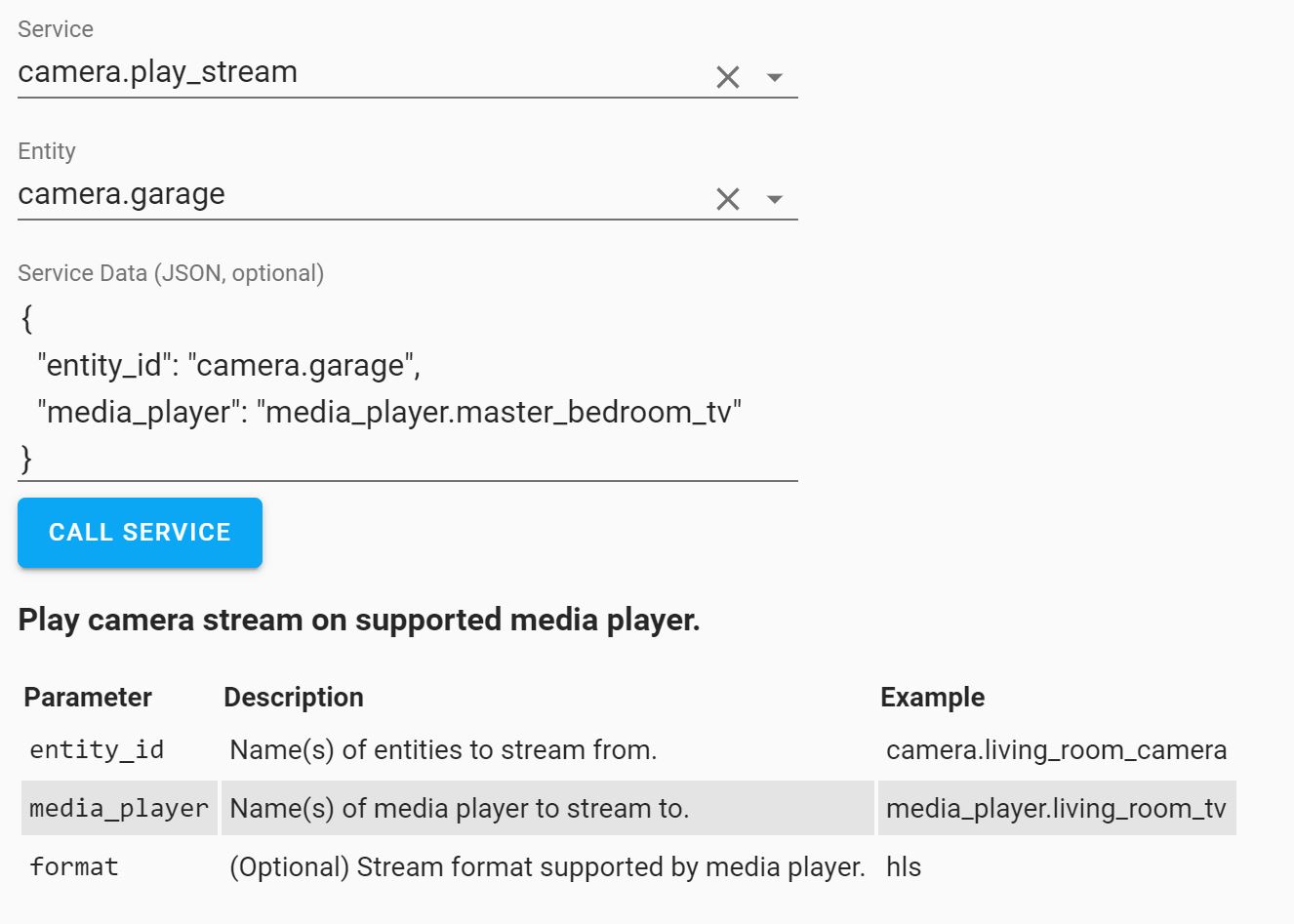

Then, I turn on Google Cast and execute the following command via dev-service:
service: camera.play_stream
“entity_id”: “camera.dafang3”,
“media_player”: “media_player.salon”
It seems it gonna work: google cast blue icon changed and a blue vertical bar started to move. However, I never see anything.
I’m seeing the same problem as @ManuelAbril but using Amcrest cameras. Casting to the google home hub or chromecast looks like it is going to start you see the player controls and then to just goes to a blue cast icon and never loads the stream. In the web UI all of the streams and snap shots load up fine. I see no errors in the logs just like the stream ends or the format sent is not in the right format. Any help or suggestions would be appreciated.

https://photos.app.goo.gl/DZ3ZgXdUuQzSm6bm6
