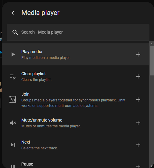

So, that’s interesting. There are two “Play Media” options in the UI.
Note the different descriptors. They even have different follow-on menus:
The first one is the one you want.
