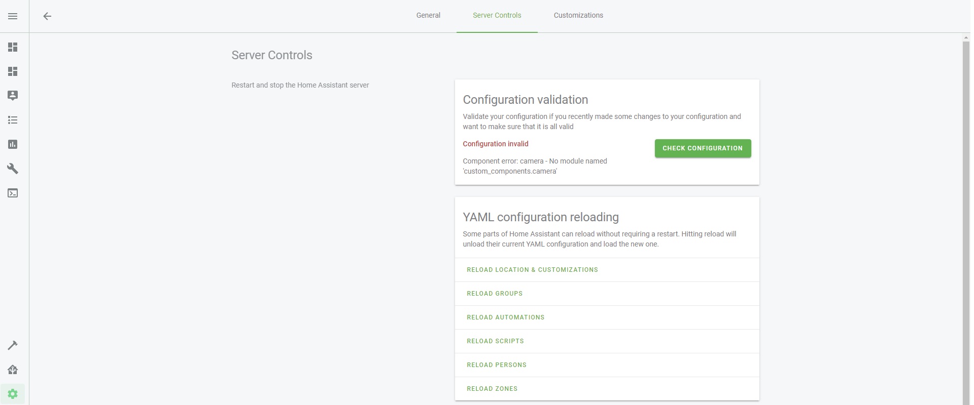

I get the error
Once I install the custom camera component I get this error

I have tried all three above mentioned ways and every time it threw the same error while checking the configuration.yaml
Error “Component error: camera - cannot import name ‘get_url’ from ‘homeassistant.helpers.network’ (/usr/src/homeassistant/homeassistant/helpers/network.py)”
