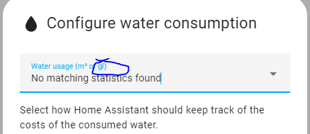

Statistics with gal don’t appear in the Energy Dashboard. This does not appear to be unique to StreamLabs. There are other posts on this. I found this one: WTH do we have Energy dashboard and no Water dashboard? - #52 by prubin100 and created a template sensor to convert gal to cubic feet and that now shows in the water dashboard.
Hello other few users of StreamLabs! So I am apparently not understanding how to add it via a utility meter. I tried to connect it to the daily sensor and it still doesn’t show up on the energy tab.
You should see your sensor in Settings/entities. It will be named sensor.whatever the name is in StreamLabs app. You will have one for daily, monthly etc.
Then go to helpers and create a utility meter sensor with your daily sensor as source. Choose daily for the reset.
sorry. I stopped paying for the Streamlabs API since it wasn’t very useful, so have deleted that item. But you need to go to Helpers and create a Utility Meter Sensor with your stream labs sensor as input source. I did it all in the GUI; no YAML
