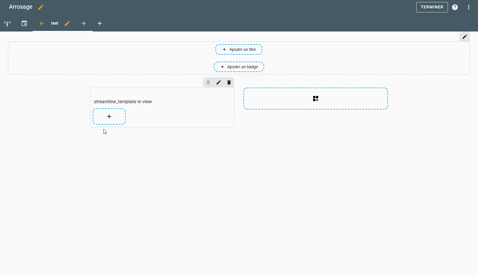

Hello @brunosabot
Is it normal to have a different behaviour if the streamline_templates are placed in the folder www/community/streamline-card/streamline_templates.yaml or directly put in the raw configuration of the view ?
With the templates in the view the visual editor works perfectly fine :
streamline_card_in_view
In this case my template start like this :
streamline_templates:
  arrosage_electrovanne:
    card:
      type: custom:vertical-stack-in-card
      cards:

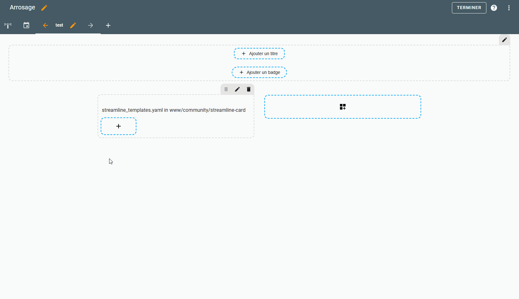

With the templates in the folder www/community/streamline-card/streamline_templates.yaml :
streamline_card_in_file
I lose the the ability to use of the visual editor and have to write all the configuration in the code editor.
  card:
    cards:
This is not a big deal for me, because i know what to put in the configuration, but as i want to share the dashboard that use streamline_templates with the french community i would prefer, if it is possible, to have the visual editor in both scenario.
I don’t know if I forgot something or if this is the expected behavior ?
