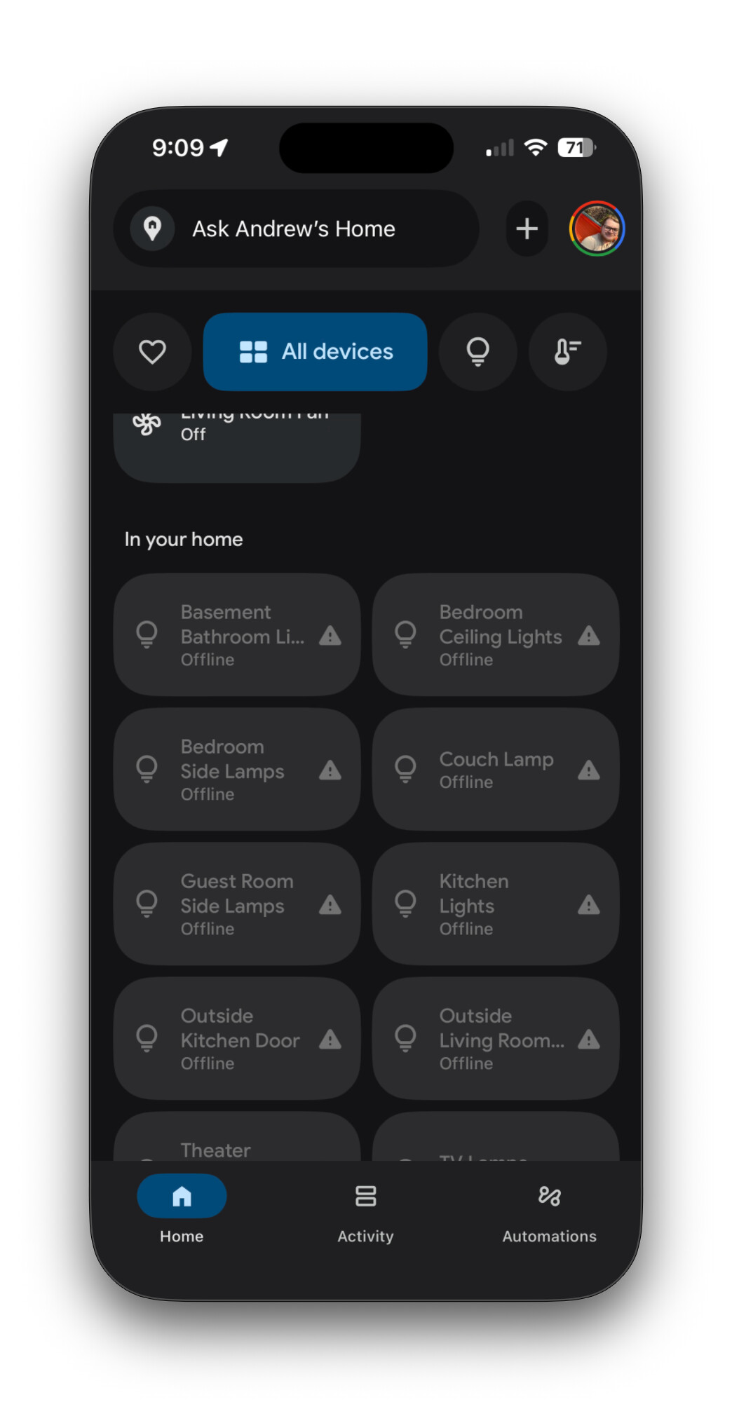

Hello! I recently changed to a Unifi network, and a Main/IOT network.
I am trying to use Home-Assistant-Matter-Hub and Google Home to allow Google Home mini’s to be able to interact with Home Assistant devices.
I previously set up HAMH, and it was working.
I have seen troubleshooting steps to enable IPV6 on Unifi, but that’s about all I have seen troubleshooting wise.
All devices are showing offline in the Google Home app.
These devices (Google Homes and Accessories) are connected to IOT vlan, and Home Assistant is connected to Main VLAN. As far as I can tell, connections between the VLANS are allowed.
Does anyone have any additional troubleshooting/setup instructions, especially when devices are on different VLANs (I’m not sure if that even matters?) or setup specifically for Unifi? I can’t get this working but I know it’s possible!
