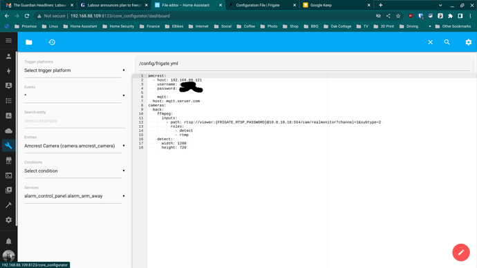

I’m having a heck of a time trying to set up Frigate.
My HA is in a Proxmox VM. I’ve installed MQTT and the broker. My camera is an Amcrest and is set up (I already use Blue Iris). It’s showing in HA Entities. Frigate NVR (Full Access) addon is installed. I’ve added frigate.yml to config and added camera and MQTT info. No matter what I do I can’t integrate Frigate. I keep getting, “Failed to connect”. I’ve tried so many things that I forget where I am. Very frustrating.
I’ll include below my log from the Frigate addon and some screenshots of my setup. Could someone take a look and, perhaps, tell me where I’m screwing up?
Here’s the Frigate log:

[2022-08-15 07:34:16] frigate.app INFO : Starting Frigate (0.10.1-83481af)
*** Your config file is not valid! ***
*** Please check the docs at ***
*** Configuration File | Frigate ***
*** Config Validation Errors ***
while parsing a block collection
in “”, line 2, column 3:
- host: 192.168.88.121
expected , but found ‘?’
in “”, line 7, column 3:
host: mqtt.server.com

*** End Config Validation Errors ***
