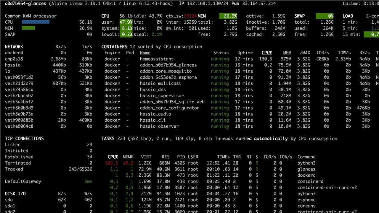

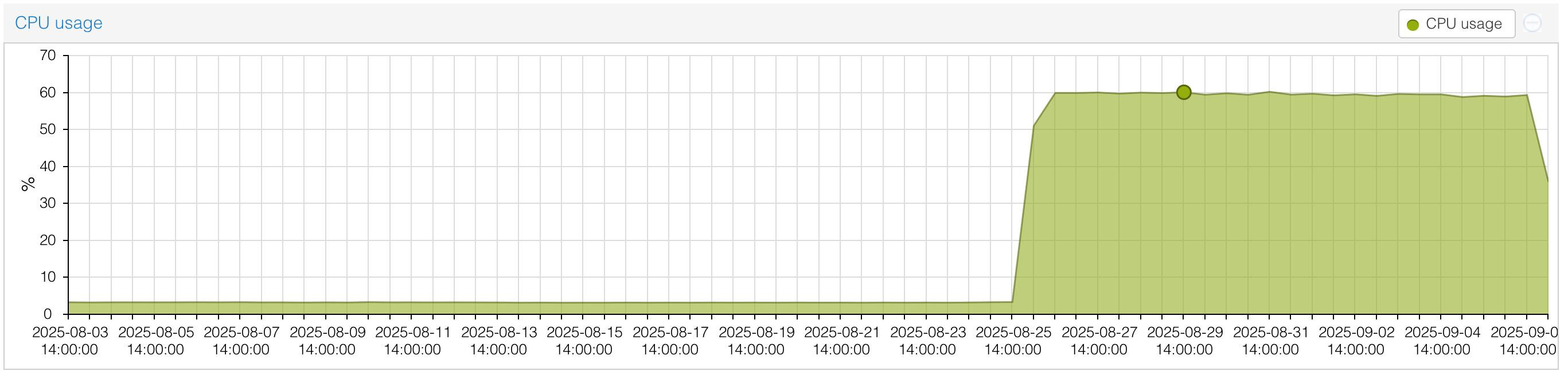

Any version higher than 2025.7.4 will result the CPU going from avg 3-5% to 60% or higher. Dashboards will load very slow (web and mobile app), some charts take almost forever → not usable
What I know so far:
With the glaces add-on I can see that it’s the homeassistant container that’s always going to 115-125% CPU if I update to any higher version than 2025.7.4
