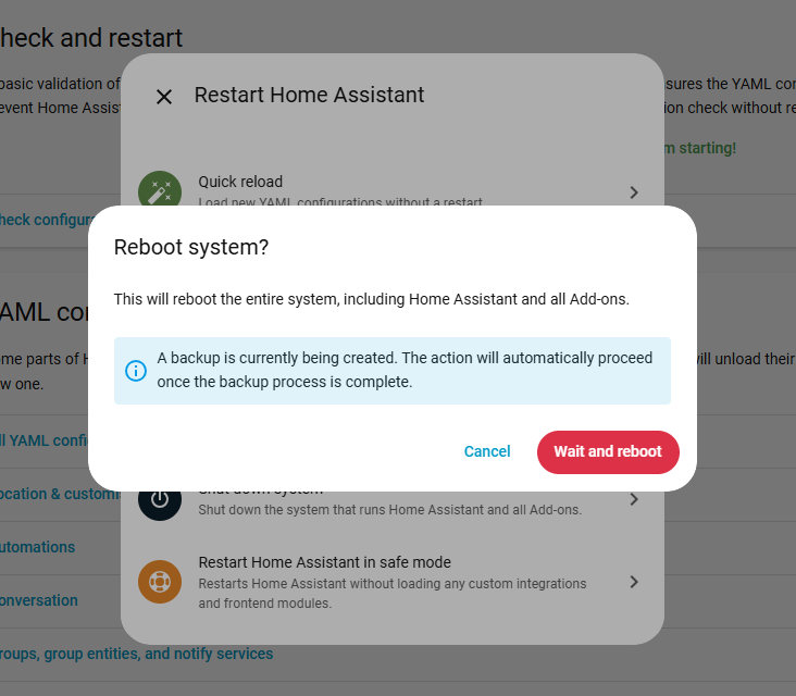

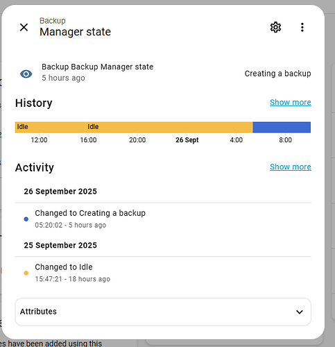

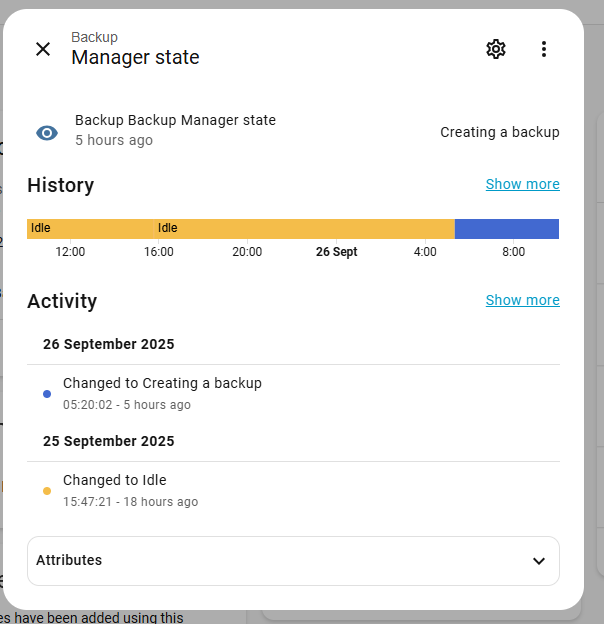

I just updated to 16.2 yesterday, and it went fine, However overnight, my usual backup ran and it appears to be stuck
It has been running for 5 hours.
Looking at, it appears it created a local backup, plus one in google drive, but it isnt liking updating to nabu casa
Is there a way to cancel the backup

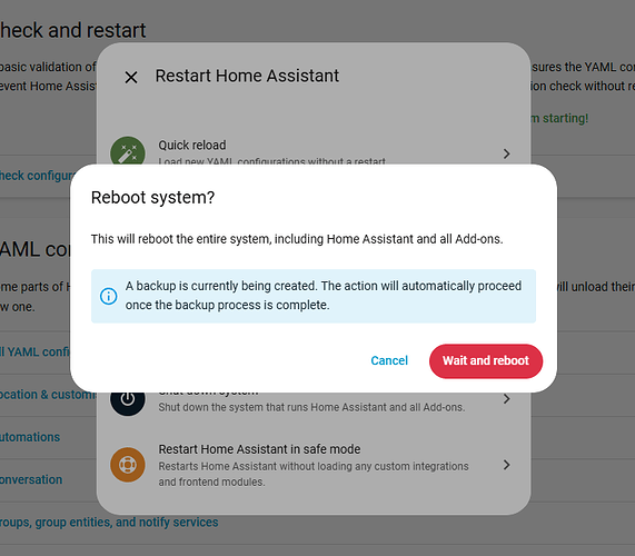

I went to reboot the whole system, but it doesn’t allow me
Its trying to upload
