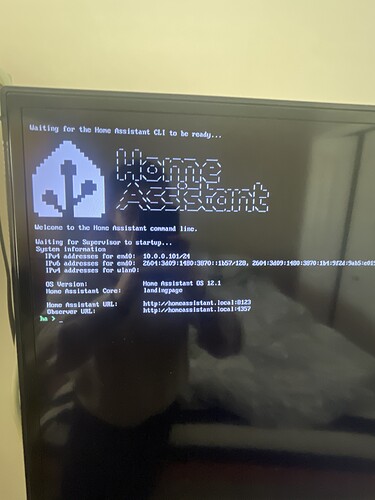

I have the exact same message on my raspberry pi.
I tried reformatting my disk, re imaging it. Can’t get it to boot up normally on a raspberry pi 4. Any help
Would be appreicated
I think it’s meant to look like that on the HA device.
log in
Log in to this address with your phone or PC.
It’s not always intuitive to new users, but HA is designed to run as a server (on your Pi in your case.) It should run there 24/7, so it can monitor and control all the devices you will set up. You don’t access HA from the server (your Pi) itself, but from any other devices on your network you like, in a regular browser by using the IP address.
