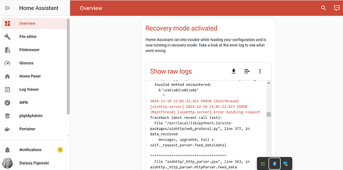

Since 3 days I have the same problem… Trying to reboot few times - but still the same… Other proposed actions - also nothing helped…
Problem occured when I updated to version 14.0.
Now I’m restoring from back-up of 18.12.2024. I think the latest working version was somethink like 13.6 (if I remember well).
What could be the reson of this issue???
Update…
System started from back-up, but when again installed updated - some errors are shown.
Anyone, any idea…???
