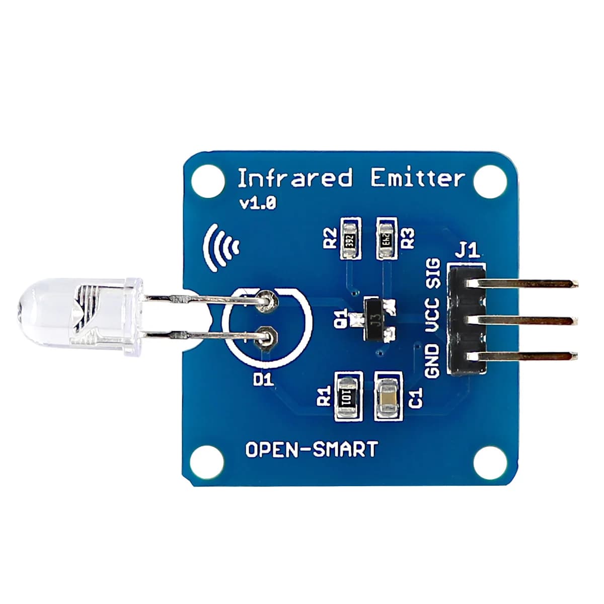

I initially tried with an Open-Smart IR transmitter board. This one has some electronics on it, so you should just be able to directly hook it up to the GPIO pins. That’s this board:
That didn’t work, with the earlier-mentioned behaviour (esphome is able to interpret the signals it sends, but the AC isn’t). Since this board is meant for 5 volts, I thought maybe it could be related to that, so I directly used an IR LED (940nm, 38khz like the Open-Smart board), and connected it with a 2n2222 and a couple of resistors. This, however, yields the same behaviour - esphome receives the data but the AC does not seem to care.

Sounds tricky. The transmitter on your photo looks valid (transistor circuit).
So if your remote gets detected and that code doesn’t work transmitted, I would think that your AC is only partially compatible with the esphome protocol. Try with dump: raw and send that signal.
