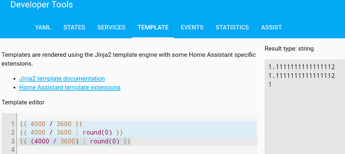

BTW, if you want, you can write the template like this:
value_template: >
  {% set s = 'sensor.load_shedding_area_eskme_13_velddriftbergrivierwesterncape' %}
  {{ ((state_attr(s, 'next_end_time') - state_attr(s,'next_start_time')).total_seconds() / 3600) | round(0) }}
Please note that you must group the division with parentheses in order for round to act on the result of the division. If you don’t group it, the round filter will act on the value 3600 only (which achieves nothing because it’s already an integer value). Therefore the final result will not be a rounded integer value but a floating point number.
