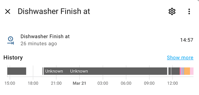

Does this already helps? I was looking in the history.
Bildschirmfoto 2024-03-21 um 09.52.52

Oh wow. Thank you very much but the response is the same time ans the finish time (dishwasher is running). Attached the screenshot of the entities. Maybe the problem is the entity of “remaining time” wich is given in min. But the calculation responses with hh:mm?
