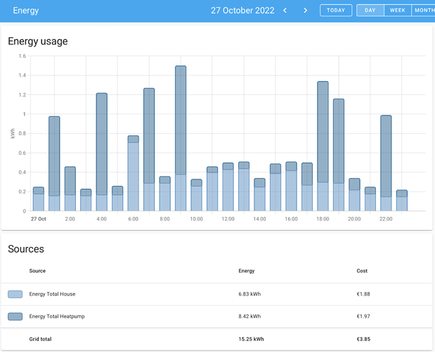

on one day in October I can see a sudden spike in the energy graph. My energy config (.storage/energy) looks like this:

You can see that the sum suddenly jumped
. Does anybody have any idea what could have happened here? It was in the middle of the night - I could imagine that the sensor (Tasmota, ESP8266) rebooted or so. But I doubt it was the first reboot. I’d really love to figure out what happened, to avoid it happening again.
My second question/concern is: Is there any guidance on how I could clean the data up?
The counters never reset btw, it’s a number that always keeps growing, the total kWh consumption.
