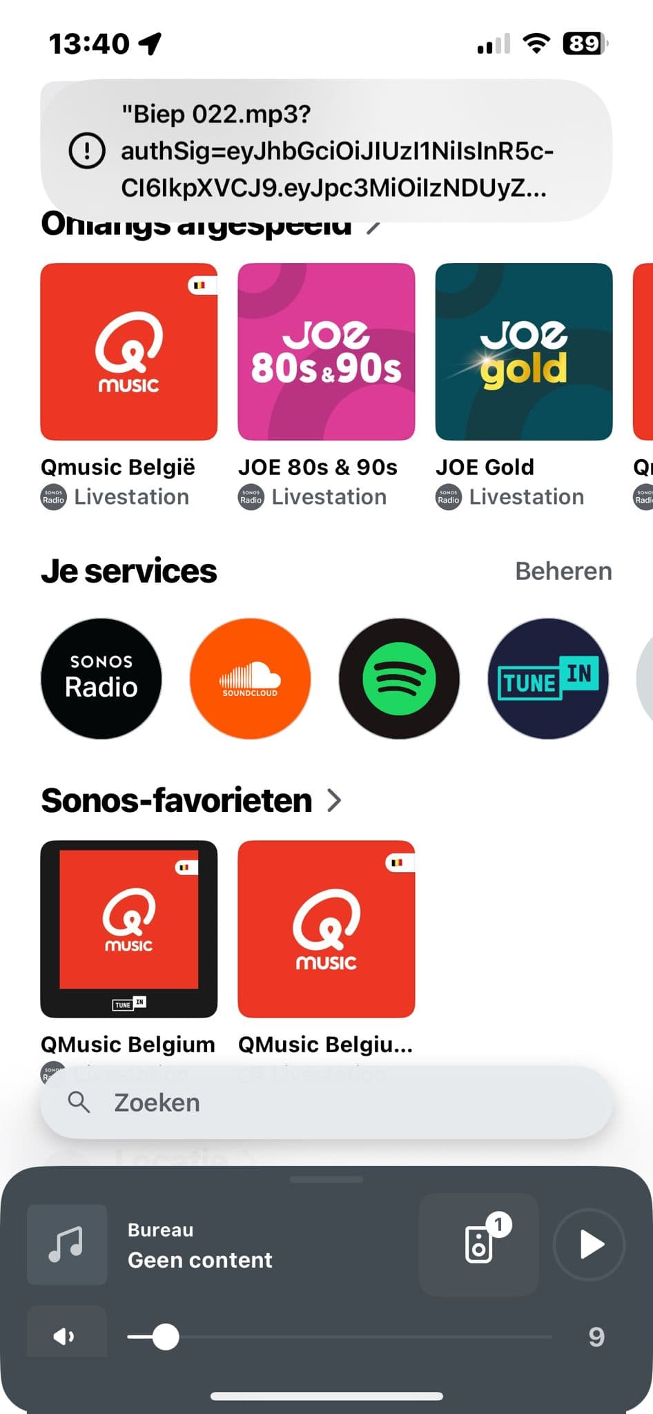

There seems to have been a Sonos update. I’ve performed it. It’s not resolved yet. I don’t see any errors anywhere. But what I do notice is that when I

test, the music cuts out and I get the following message in the Sonos app (see image).
Are you sure this have ever worked ? , for this particular “content” ?
Seeing the word Auth in there makes me think that the Sonos requires authentication, and didn’t care for HA’s request. Since this is coincidental with a FW upgrade, there is correlation.
I’d look at Sonos’s release notes and see if they’ve updated their access api and related requirements to see what that says. This is a common problem with integrated iot devices; the manufacturer updates security and integrations break.
Yes i noticed that to, but not familiar with the Sonos integration, and in particular not when playing a local media ( and with an _ID with Capital and “space” in it’s name )
