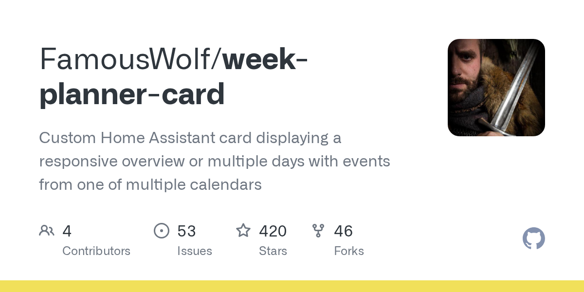

If you’re lookking for a great way to show the calendar, this is an example of what is available for native calendar entities. It also supports a vertical layout and lots op customization options:
