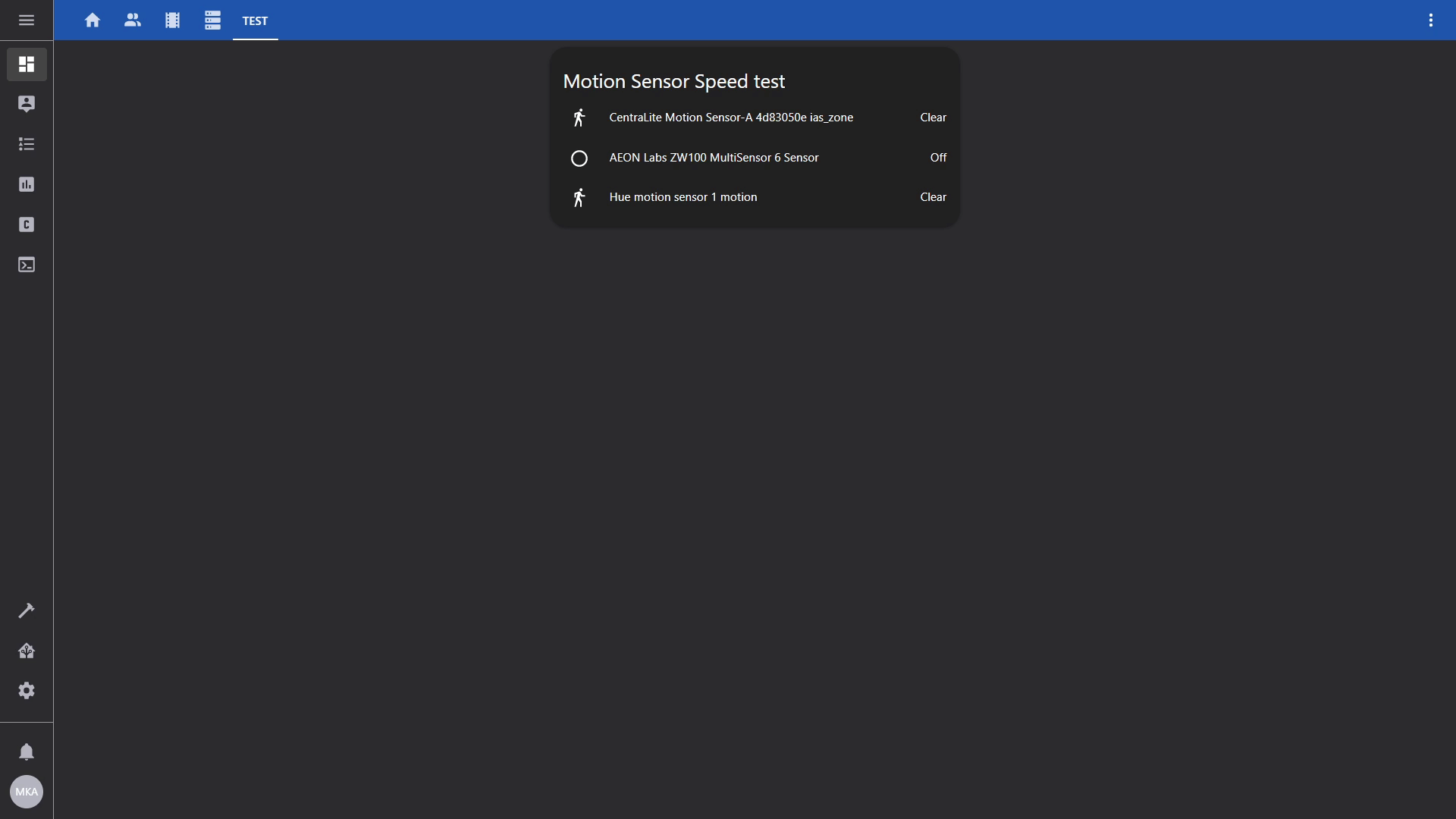

BTW: I just plugged in my old Centralite motion detector I used to use with my Wink hub. Surprisingly, it has no lag at all! Lightening quick; even for motion over 10 feet away …quicker than both Phillips Hue and Aeon Labs motion detectors every time. Not sure why that’s the case. Unless someone knows how to make the Phillips Hue or Aeon Labs motion detectors equally as quick, I’m probably going to order another one of these Centralite’s.
  1. Centralite
    Controller: HUSBZB-1 - Zigbee
  2. Aeon Labs Multisensor 6
    Controller: HUSBZB-1 - Z-wave Plus
  3. Phillips Hue Motion detector

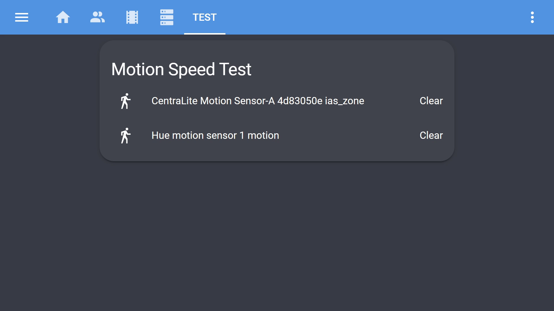

@trankillity The Fast Hue Integration did make the Hue Motion sensor faster (polling interval set at 1s). However, surprisingly it still can’t beat the Centalite motion detector which detects instantly by default (as opposed to ~1 second reaction time) …and, this is with the Hue and HUSBZB-1 controllers placed only 7 feet away from these devices (equidistant).
This reaction time difference between the two device is trivial in most cases; however, its interesting to note that the Centralite motion detector right-out-of-the-box might be one of the quickest motion detectors on the market.

I’m seeing around the same performance from the Phillips Hue Motion detector using the Hue Hub verses and HUSBZB-1.
Centralite is still a little faster every time; although, the Phillips Hue is still pretty fast (at least faster than the Aeotec Multisensor 6).
