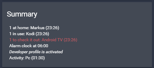

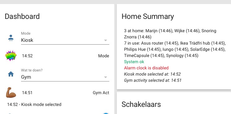

here’s my complete summary.py, ive changed several things, and added the lights section, working perfectly at the moment!
accompanying dashboard to check all went well:
Only thing i would love to see changed is a color for the lights in Summary card (cant seem to adapt the text-only html file doing so)
