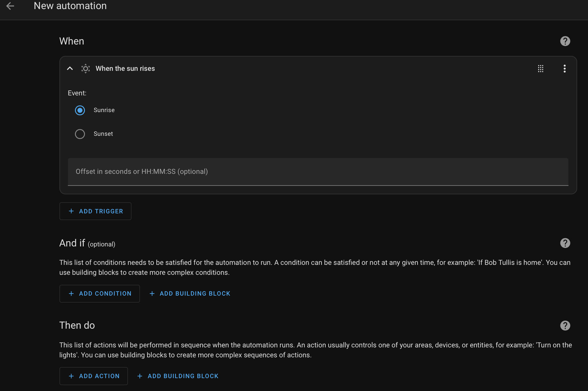

If you start a new automation in the GUI, and start by creating a new TRIGGER, there should be a few types of trigger choices displayed. If TIME & LOCATION is selected, you should see a SUN option that can be selected in order to get to the following dialog:
If you don’t get to there. . . I don’t recall if this requires the SUN integration to be installed. It’s been a minute since I went to SETTINGS / INTEGRATIONS and added the SUN integration, but I suppose this is why I did it. [:thunk:]
