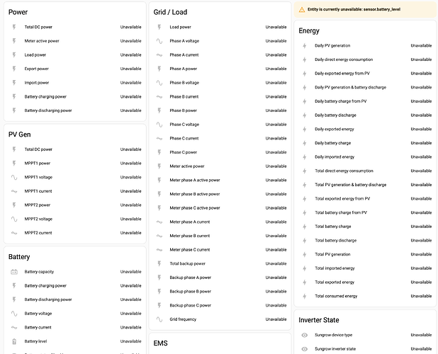

Thanks for sharing this. I am giving it a try. Everything is setup but unable to figure out where to see the data in HA.
Please help.

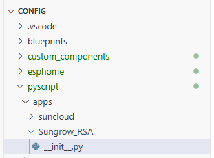

What you are showing is a very basic error, it just cannot find the main code. Either you don’t have the routine update_device_data_rsa or it cannot be called from the integration.
The routine is included in file __init__.py. Follows a screenshot of my folder structure.
This file includes the following at line 262:

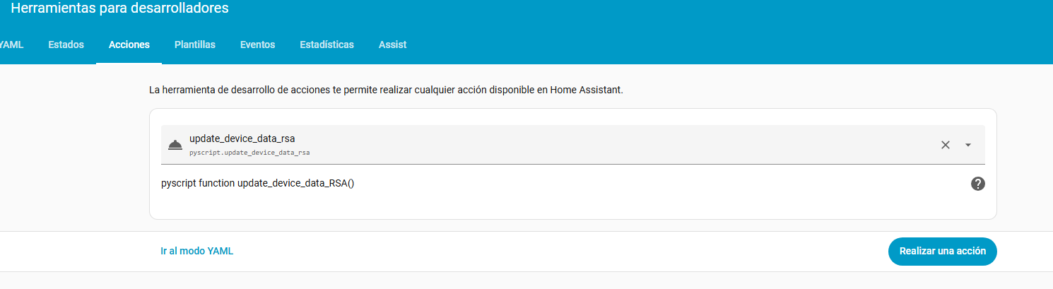

The ‘@service’ is what makes it public. In Developer Tools / Actions you should see an action that calls the routine. I’m enclosing an image, sorry it is in Spanish:
If you cannot see it, then the automation cannot execute it, and you would get the error you mention.
So, if changing pyscript/config.yaml doesn’t work, maybe you are missing some step in the installation. Make sure you have installed the Pyscript integration and have created and modified all needed files.

But still it is not working. I mean I am not getting any data loaded in to the new sensors created.
Any ideas where to look for the issue?
Inverter: SG5KTL-MT
Communication Module: WiFi V31

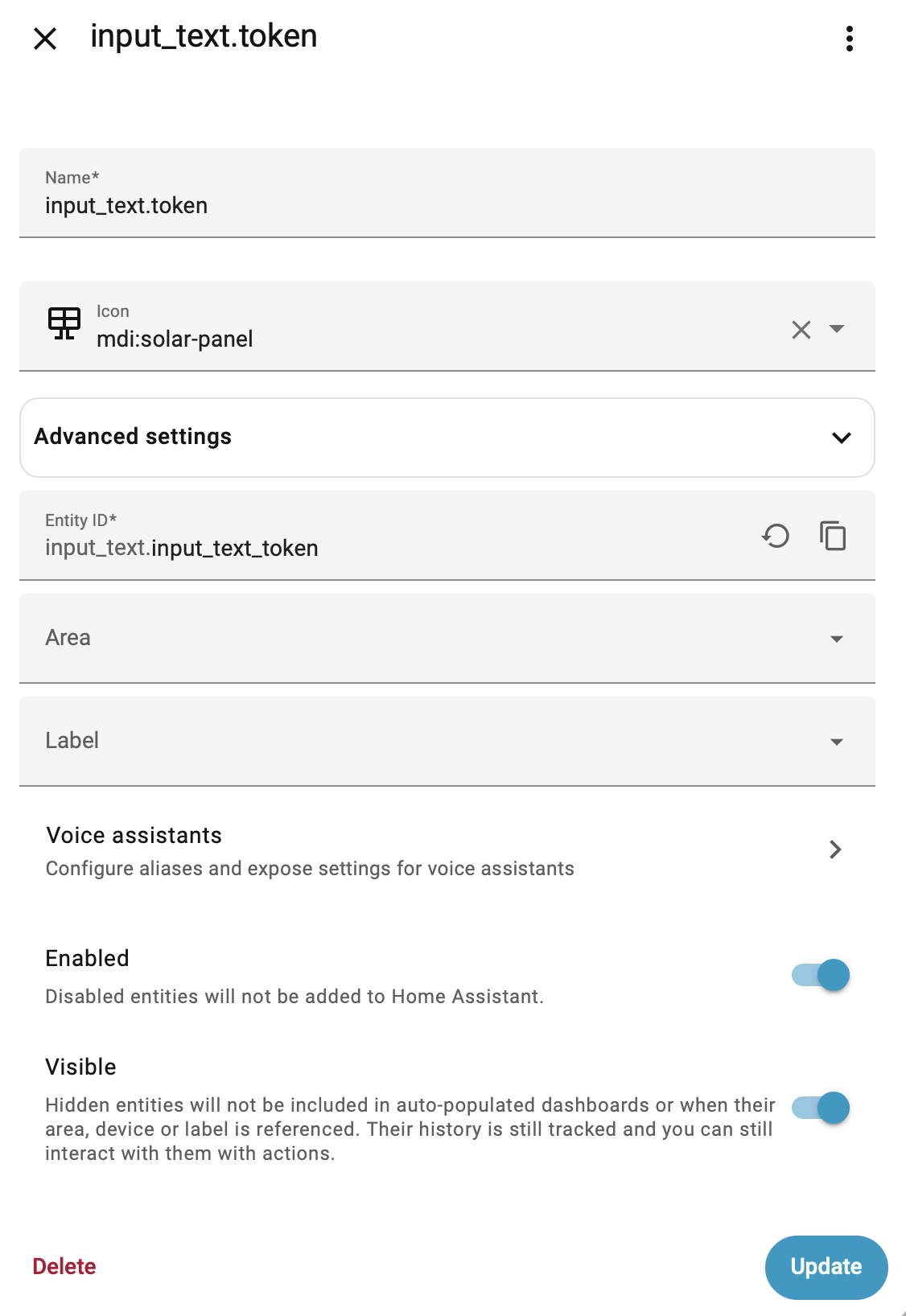

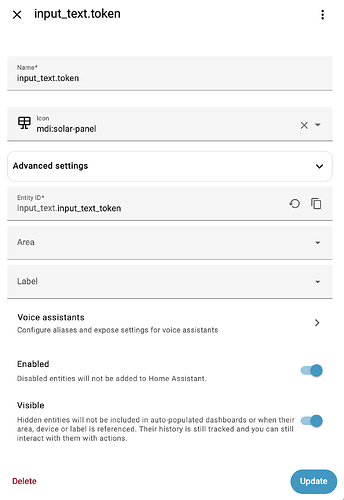

Does this look good?
I can check tomorrow only if it’s working as I don’t have battery and currently solar is off.
I have also updated the ps_key_list and point_ID_list.
“# symbol removed from #log.info”.
When creating the text helper, the name should be ‘token’, instead of ‘input_text.token’. The ‘input_text’ part is added in the code to call that helper. Remember to reload all YAML configurations in Developer Tools so HA accepts the changes.

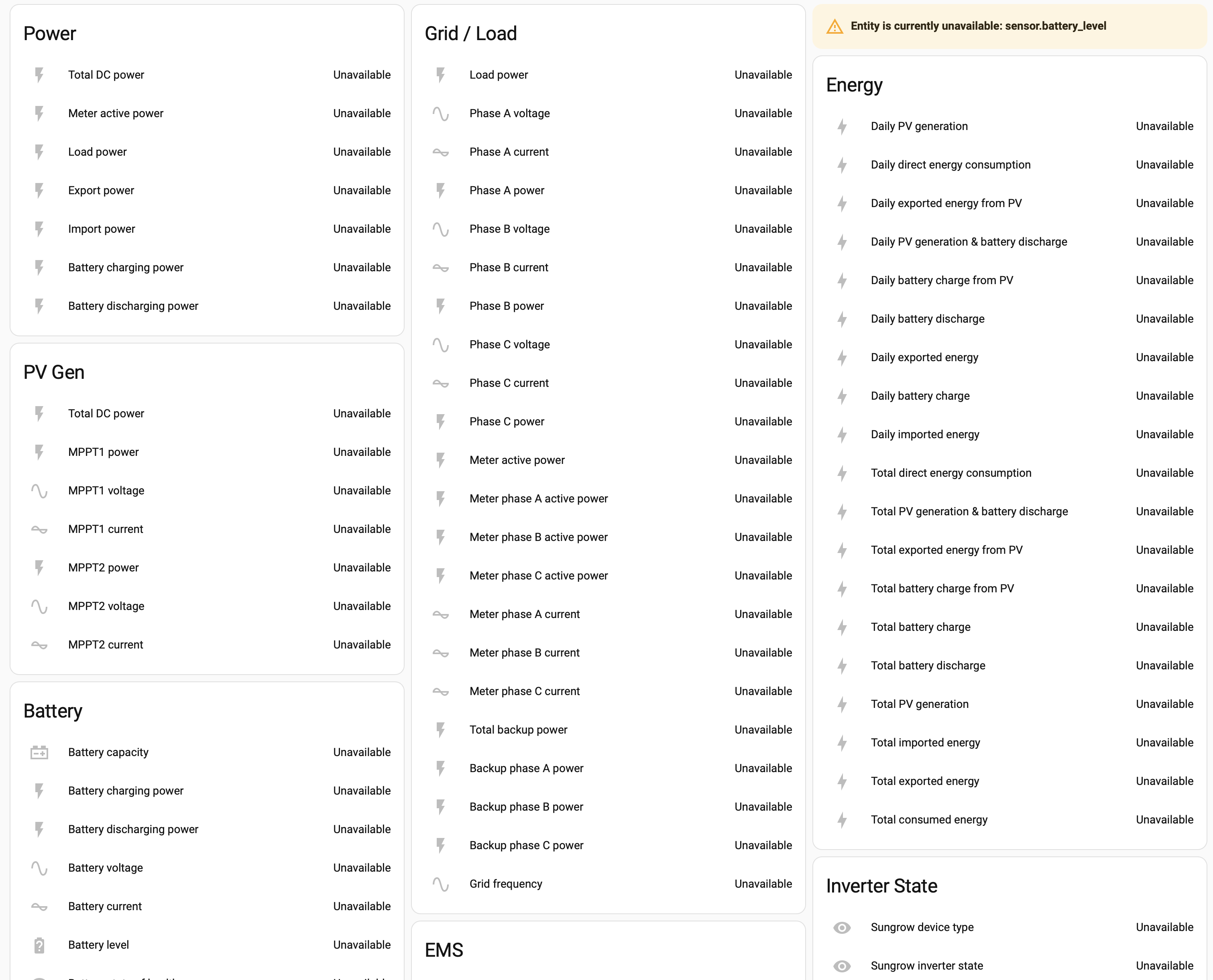

If the system is connected you don’t have to wait until tomorrow, all energy and equivalent hours data, for instance, have values accumulated throughout the day and will not reset until midnight. You will just see a 0 for all production values (which would be correct).

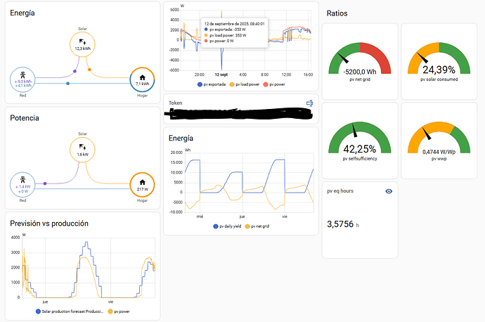

Follows a screenshot of my HA with all values:

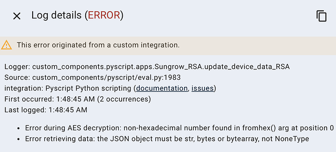

Getting this error:
Is there anywhere else to view automation logs?
I am getting the same error PC007.
Did you figure out how to fix this?
