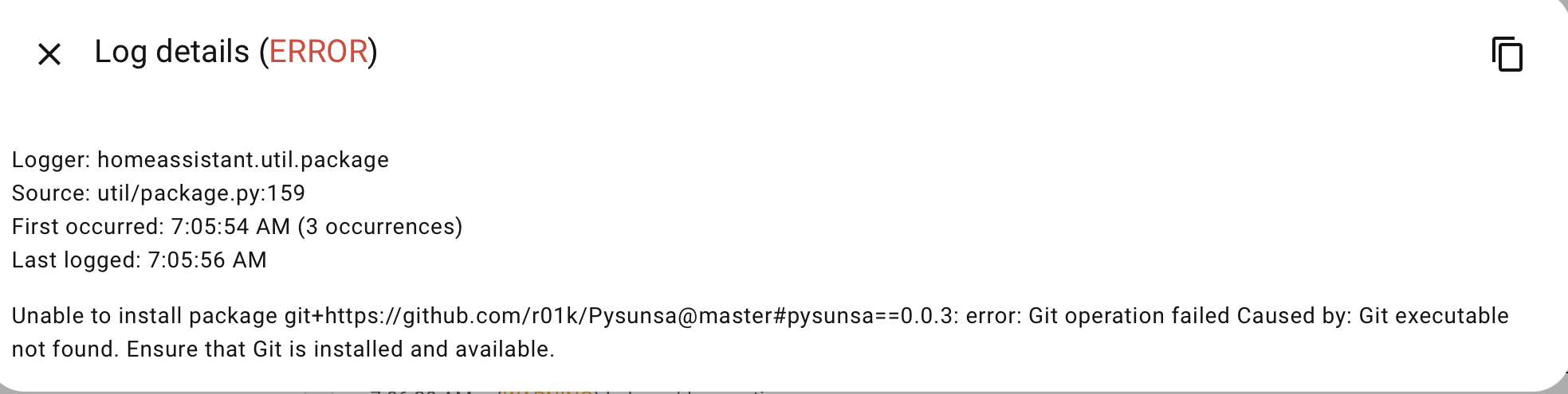

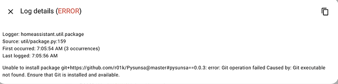

The Sunsa integration is failing to load in 2025.10.0b0. I filed an issue in GitHub here (https://github.com/r01k/ha_sunsa/issues/5) but also thought I’d post here in case people had more ideas here. I’m an amateur at all this, but from what I can tell from chatGPT and looking through the log, it isn’t able to load pysunsa anymore - most likely a change in 2025.10? Any ideas how to fix this?
Just closing the loop on your question. I see from your Github issue that it is solved and closed.
