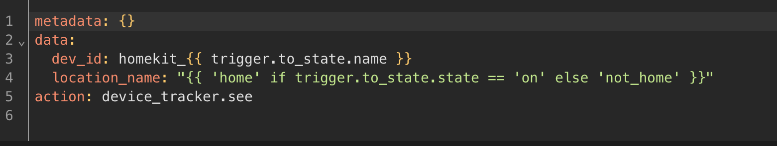

I only have Apple devices to track in our family so I have a quite reliable HomeKit tracking automation like this:
This also works if WiFi is switched off on the client device because the location part is handled by Apple.

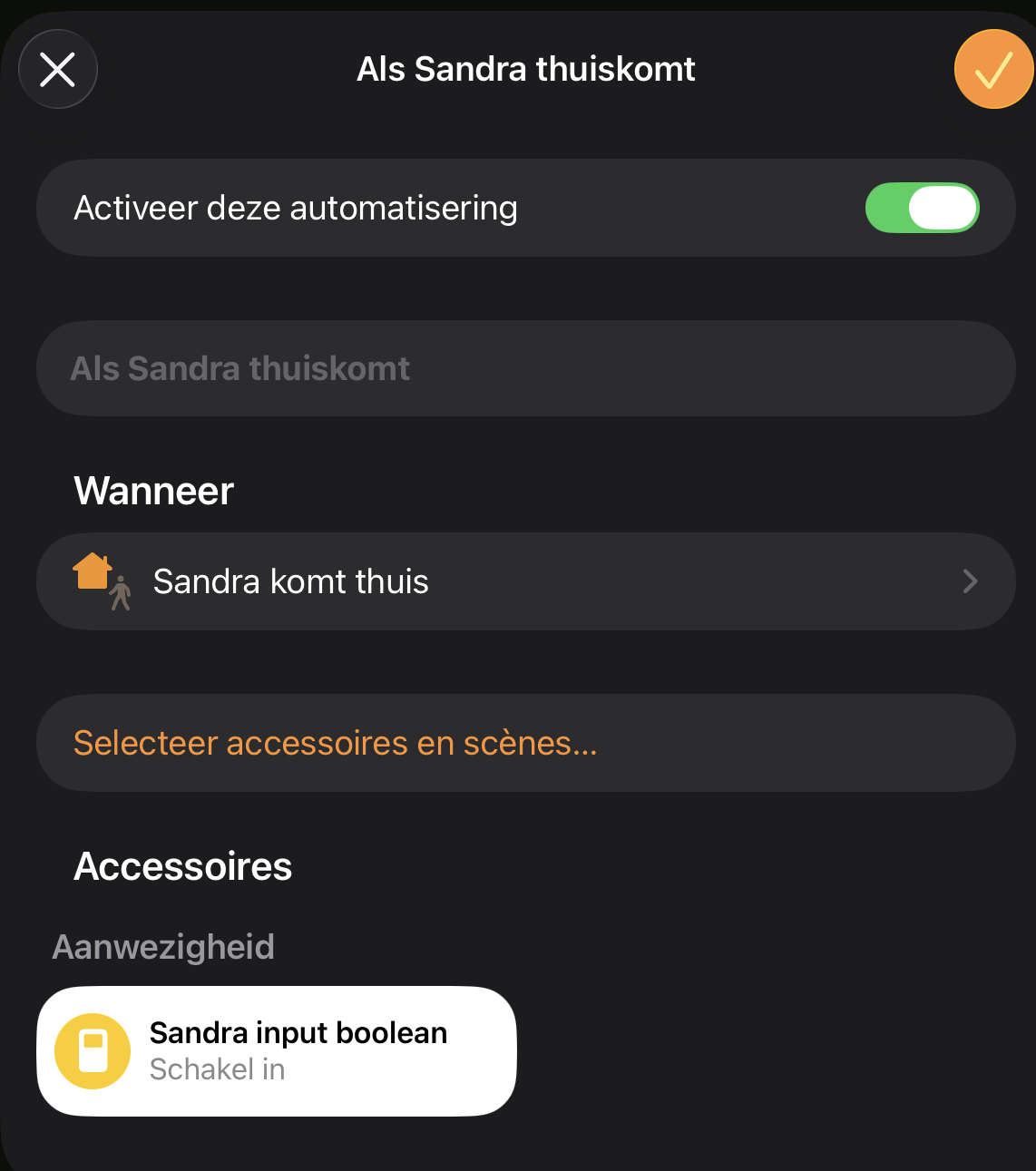

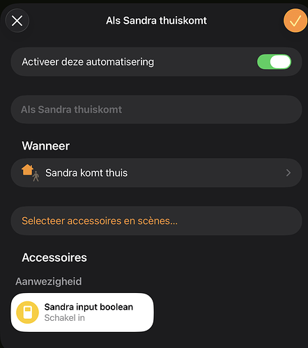

@Cabledude I’m curious if your bit of code needs HomeKit automations. I have a configuration where I have automations for HA input_booleans that show as switches in HomeKit. Setting those on and off in HomeKit allows HA to see presence. Did you need to do something like that as well to get your bits to work or something simpler? I"m speaking strictly of the HomeKit presence integration, not WiFi tracking.

@yodiyossarian Yes the HomeKit presence detection uses booleans for each person in HomeKit. The HomeKit automations are nothing more than setting those booleans upon enter/leaving home.
