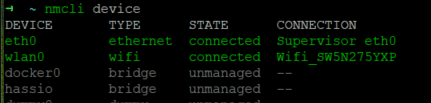

I’m using eth0 LAN for my main connection and I have also connected WiFi wlan0 to my Solax inverter:
I used the cmd: nmcli device wifi connect “my solax serial” - to connect it to my wifi
Immediatly after this connection is activated, Supervisor card becomes blank.
It looks like HA is trying to use this WiFi connection instead of eth0.
