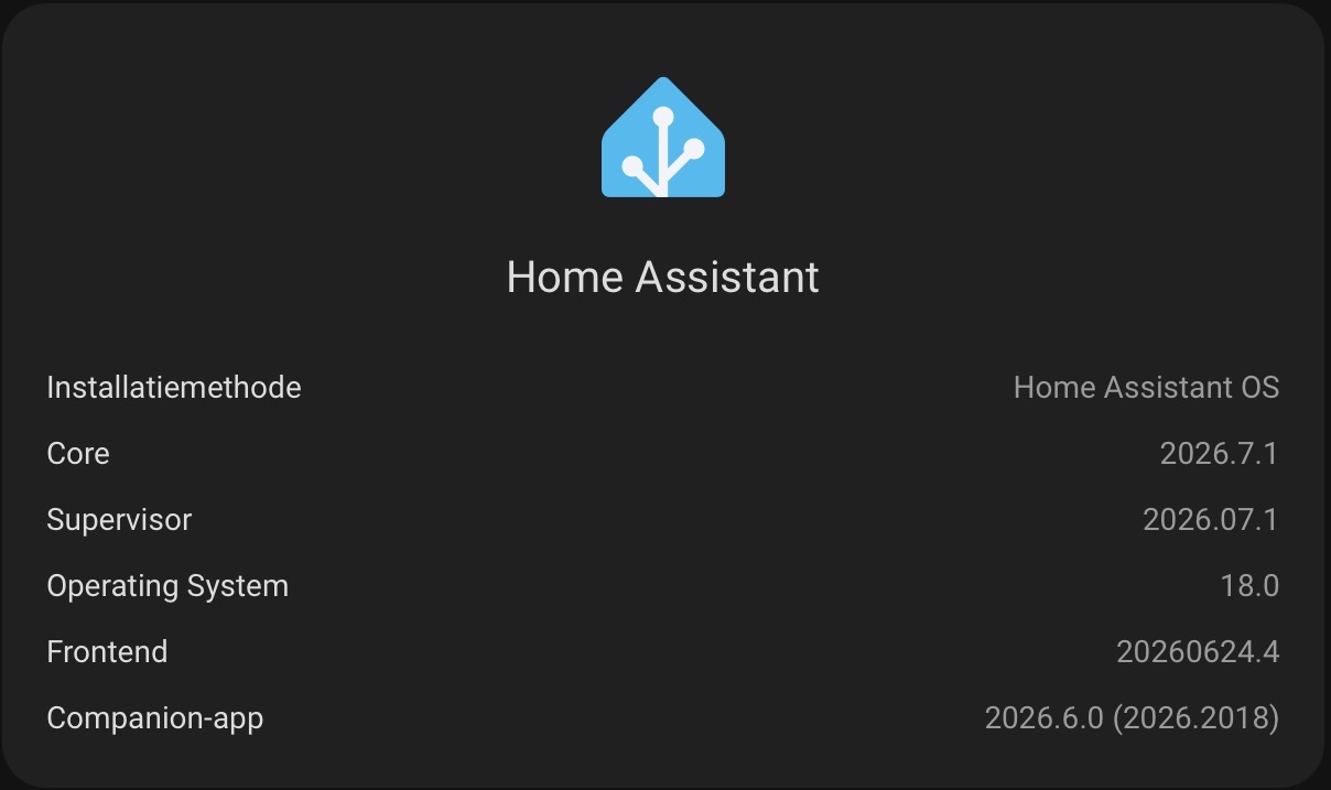

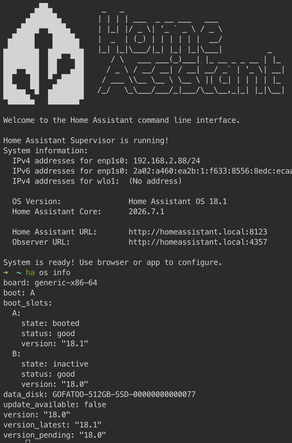

Supervisor reports a different version in the UI than it does in the console. It seems to think I booted the alternate boot partition. What lead to this was this:

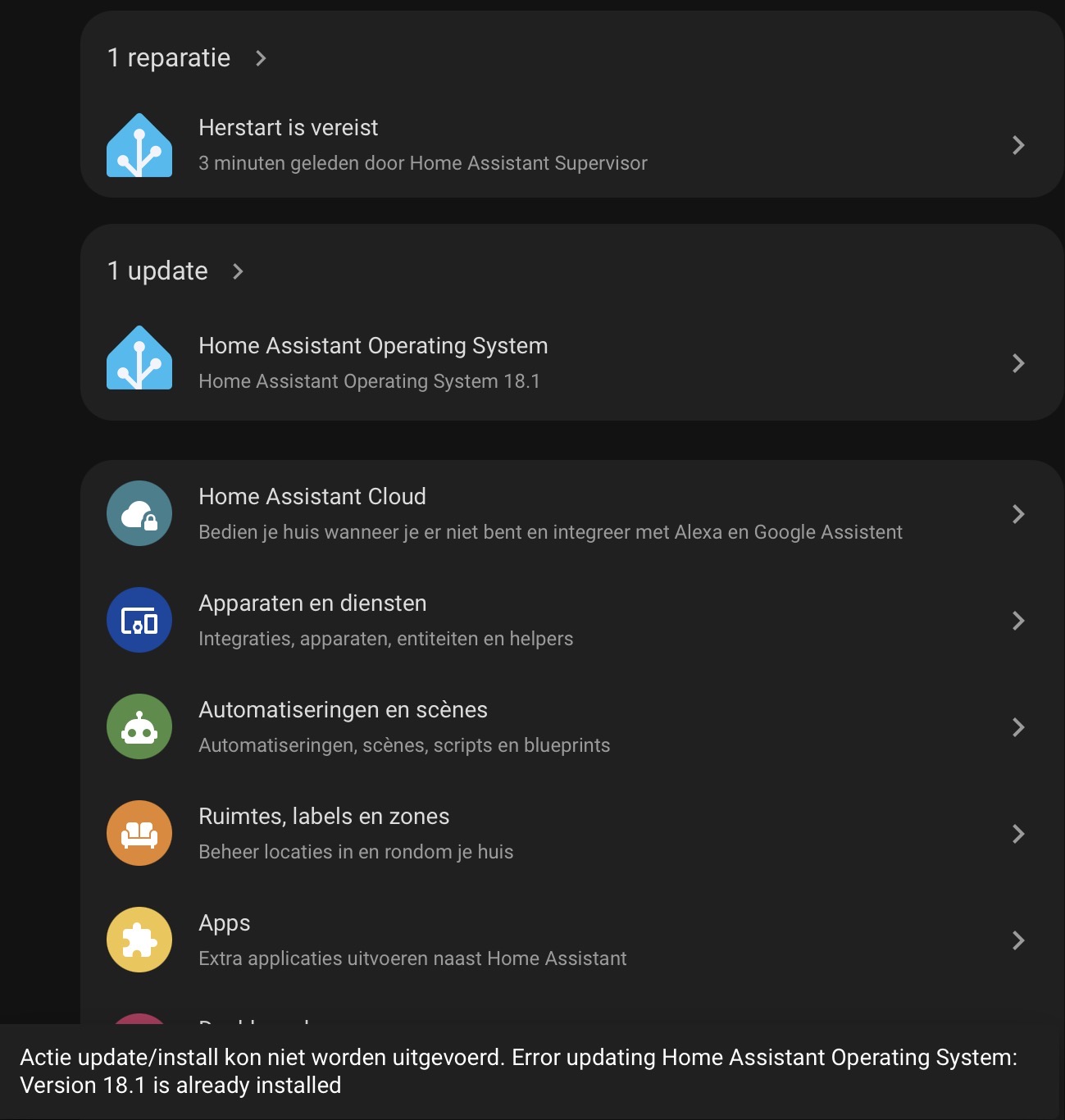

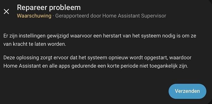

I shut down HA for a power cut, but somehow the shutdown was apparently not complete. After that, hardware reboots took close to 30mins where HA was not available at all, not for SSH either. It seemed like it failed to boot and switched boot partitions to work. It showed a repair that something had changed and it needed a reboot. It also appeared to have booted HAOS 18.0 instead of 18.1 which I had run before.
Several attempts later at installing HAOS 18.0 and 18.1 and switching boot partitions, a hardware reboot now progresses at normal speed on both boot partitions. However, the nagging repair remains, and Supervisor reports the wrong OS version in the GUI. The CLI shows it booted the other partition.
Does anyone have any clues how to fix this? note all the differences in the CLI version and the gui, and also the GUI being confused it should update the OS. When I try it notices the new version is already installed:
