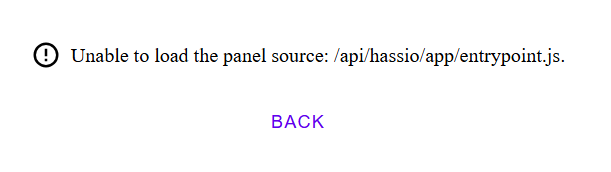

I keep having significant problems with Supervisor where it just won’t start - details/screenshots below.
I am managing a few different home assistant instances and several of them had the issue by now, my own has even had it several times. Usually this is fixed by a restart. But since supervisor and addons are unavailable, I have to do this manually.
I’ve found a couple other threads on this as well, but basically all of them either fix it by restarting or by doing something in the terminal. Both of which I can’t do remotely because supervisor is down. And even if SSH was available, I feel quite uncomfortable to make port 22 available on all my friends/family.
So honestly, I’d like this to not happen again :sweat_smile:
I can’t really make out why this is happening and how to avoid it in the future.
Can you help me out? Please let me know if you need any information from logs - not even sure where to start with this :confused:
some screenshots
when trying to access addons settings:
when trying to open an addon (e.g. terminal)
Home Assistant observer:
last log lines are (and yes, it is cut off there):

How much free space do you have on the media?
What installation are you running and on what hardware?

SD cards are not the best for a system like HA that writes a lot.
32Gb is also a bit on the edge, especially if you also store local backups.
The reason I pick on the media is the log output, which looks like it simply stoppe writing there, because there where no more space.
A restart will then delete homeassistant.log.1 and rename homeassistant.log to homeassistant.log.1, which frees up space again to run, but only for a somewhat short period of time.
11Gb is a lot to fill for logs, but if the recorder is not managed, then it can eat up a lot too and maybe it will fail with a corrupt database then too, which means it will do the same as the logs and overwrite an older corrupt database backup and thereby free more space.
