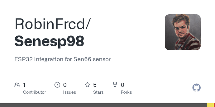

For those interested, I made a ESP32 integration for the Sen66 in January 2025 with a Z2M integration. Has been working like a charm since then, super happy with it !
