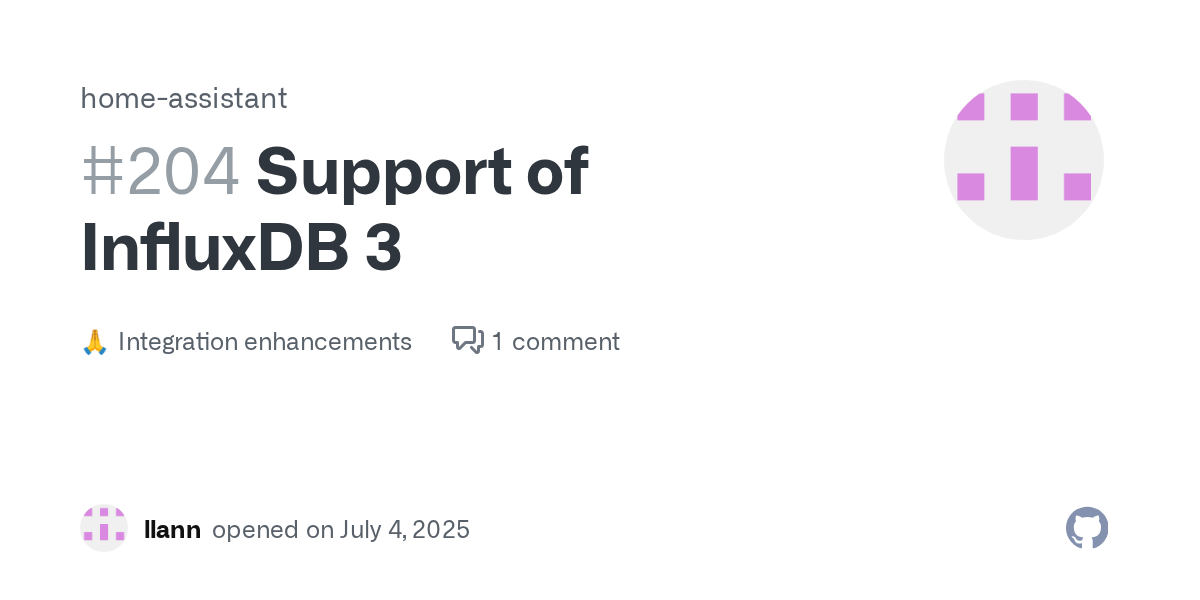

You can always upvote this request to support InfluxDB v3
